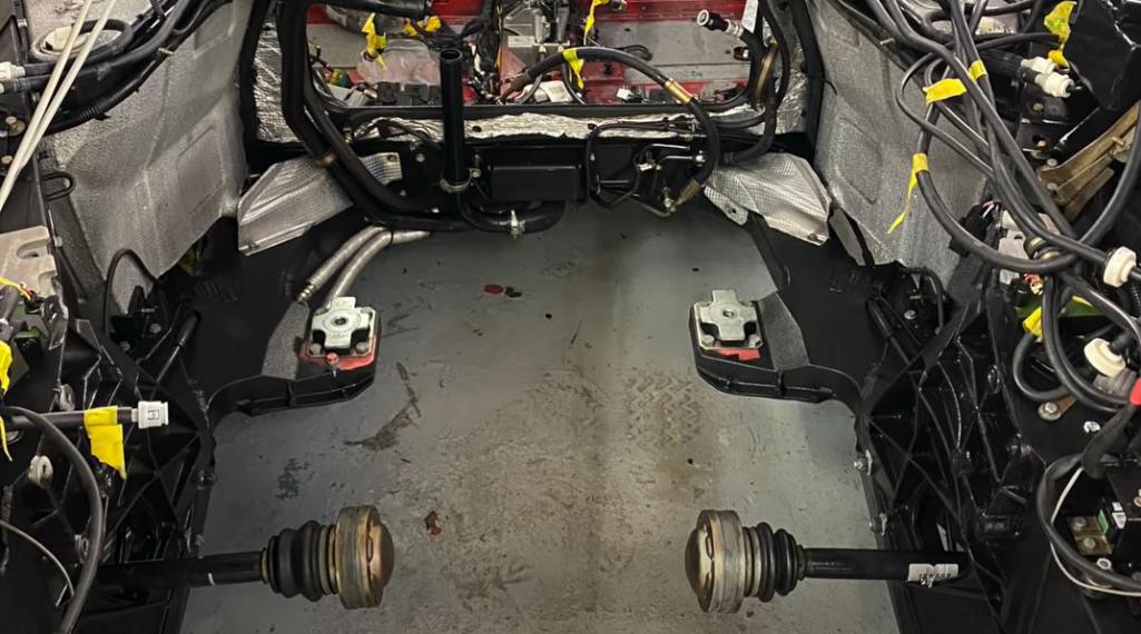

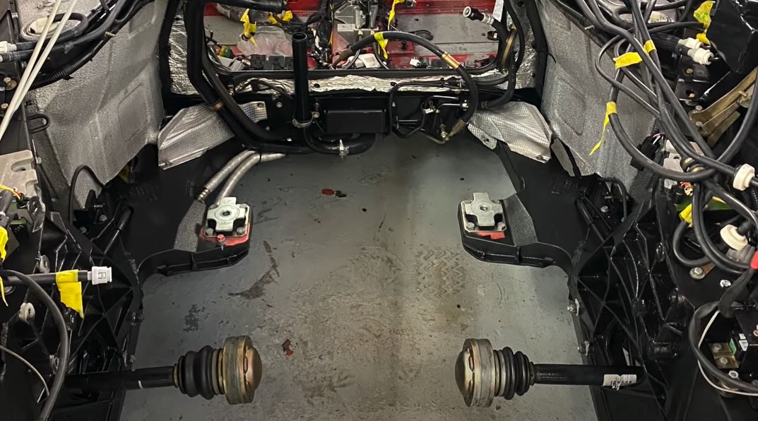

Drive train mounting: Initial planning
I initially assumed this part would be easy. Just do it like my LS. I mean, the Ferrari has mounts on the side of the block, same as the Chevy, so just run a cross bar underneath and work out how that'll mount to the chassis. Easy!
Turns out, not so much. Being a dry sump, there's no room for a cross bar. We'll there is a small area towards the rear of the engine, but it's in the way wrong place, relative to the mounts on the block. So, I started looking for info on how the engine mounts in the 360 chassis.
SURPRISE! The one video I found shows it being removed out the top of the car. Not what I'd expected. You can see in the pic, the chassis has the two outriggers that support the engine mounts. I could do something like this but then the engine would have to go in/out from above - which means all the rear of car chassis stiffening and transaxle mount would have to bolt in. I don't think I want to go that way.
I'll get into more detail later but at this point, it's looking like there will be a couple removeable, intermediate "hanger mounts" that will bolt to reinforced areas on the chassis to provide those "landing pads" for the engine mounts. These will bolt in once the engine is raised up from underneath. For transaxle mount, there'll be a cross bar/support structure, similar to what's in my LS car, that will grab that single trans mount.
Lots more planning to do but I think I'm getting an idea of how it'll all work.

tygaboy   @shivers - I'm a newbie to all things Ferrari...   May 6 2022, 08:54 AM
tygaboy   Drive train mounting: Initial planning I initially...   May 6 2022, 09:35 AM
ClayPerrine   Drive train mounting: Initial planning I initiall...   May 6 2022, 11:04 AM
tygaboy   Drive train mounting: Initial planning ... Why ...   May 6 2022, 12:26 PM
