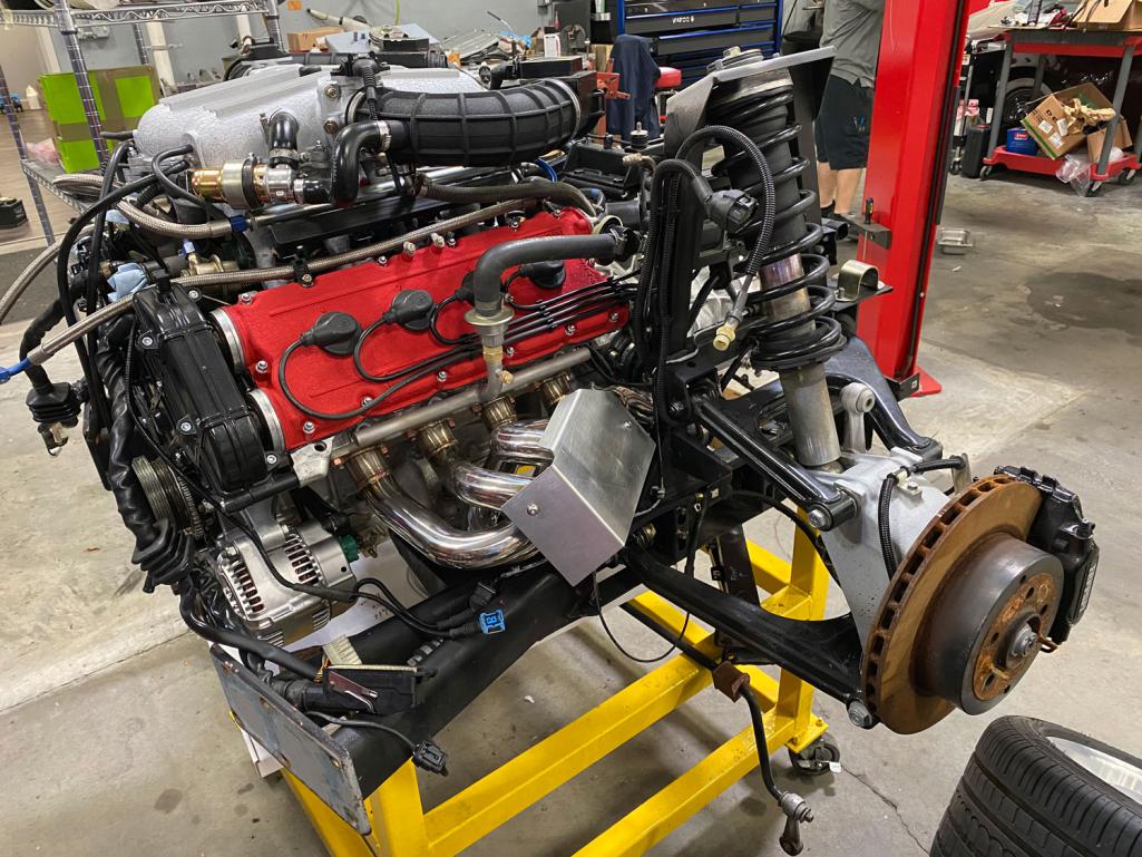

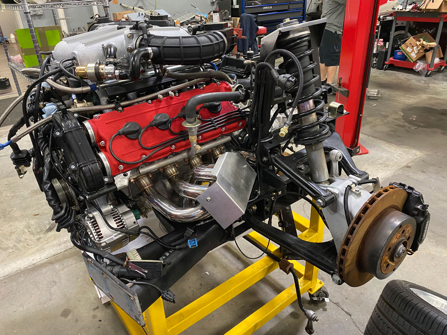

Chris - RE: Engine cradles and such: More food for thought in the shape of what Ferrari did with the 348 model (see pic). The removable cradle extended to mounting the suspension components, actually forming part of the car chassis. Boxster struts and lower links might be substituted...?
You would likely end up removing a lot of metal in the rear of the 914 chassis to do something like this which you may not be comfortable with.
Something to think about,
- Tony
