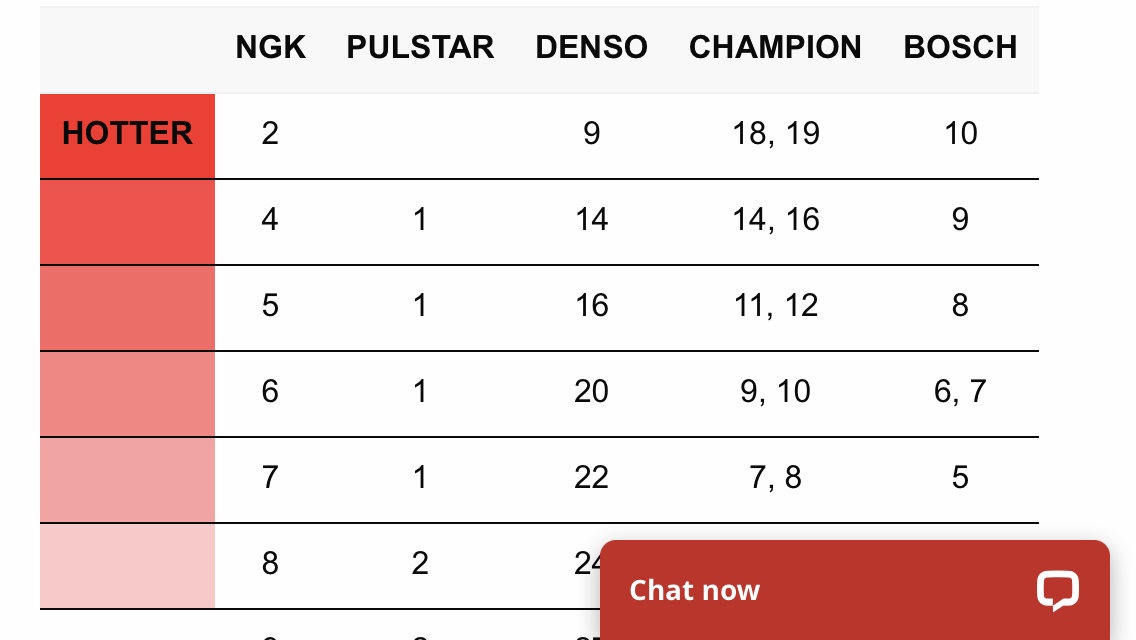

Thanks for your input, guys. Based on that, the Bosch “5” may be a little too cold … the NGK “5” is equivalent to a Bosch “8”, and the NGK “7” that “slivel” raced with equivalent to my Bosch “5’s” on the Bosch cross reference chart. (Bosch and NGK numbering systems run in opposite directions wrt heat range.)
