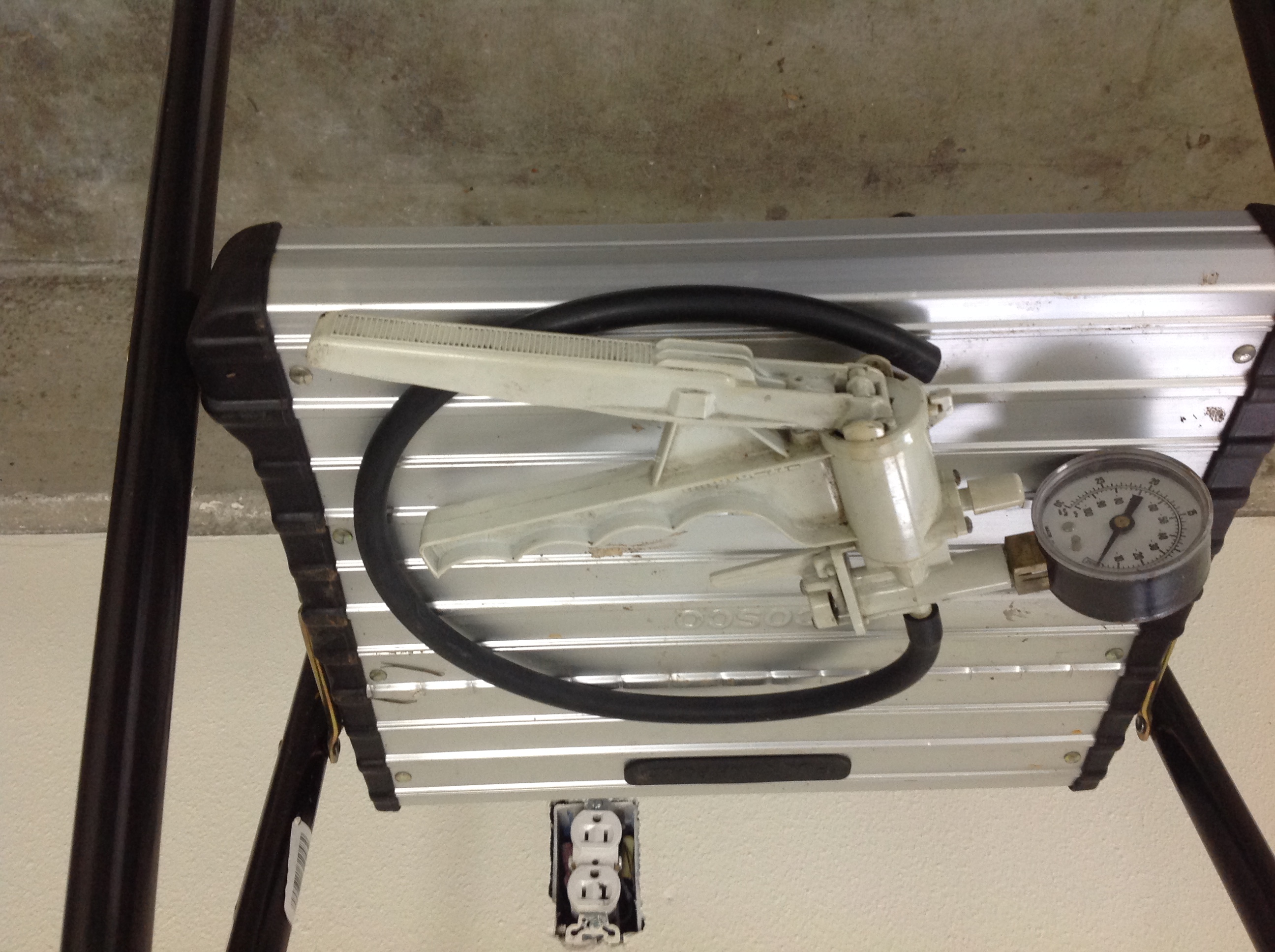

I just did the vacuum test on MPS and I could not get the pressure above 10 and immediately would drop down.
So, if this not the issue, it is ONE of the issues.
