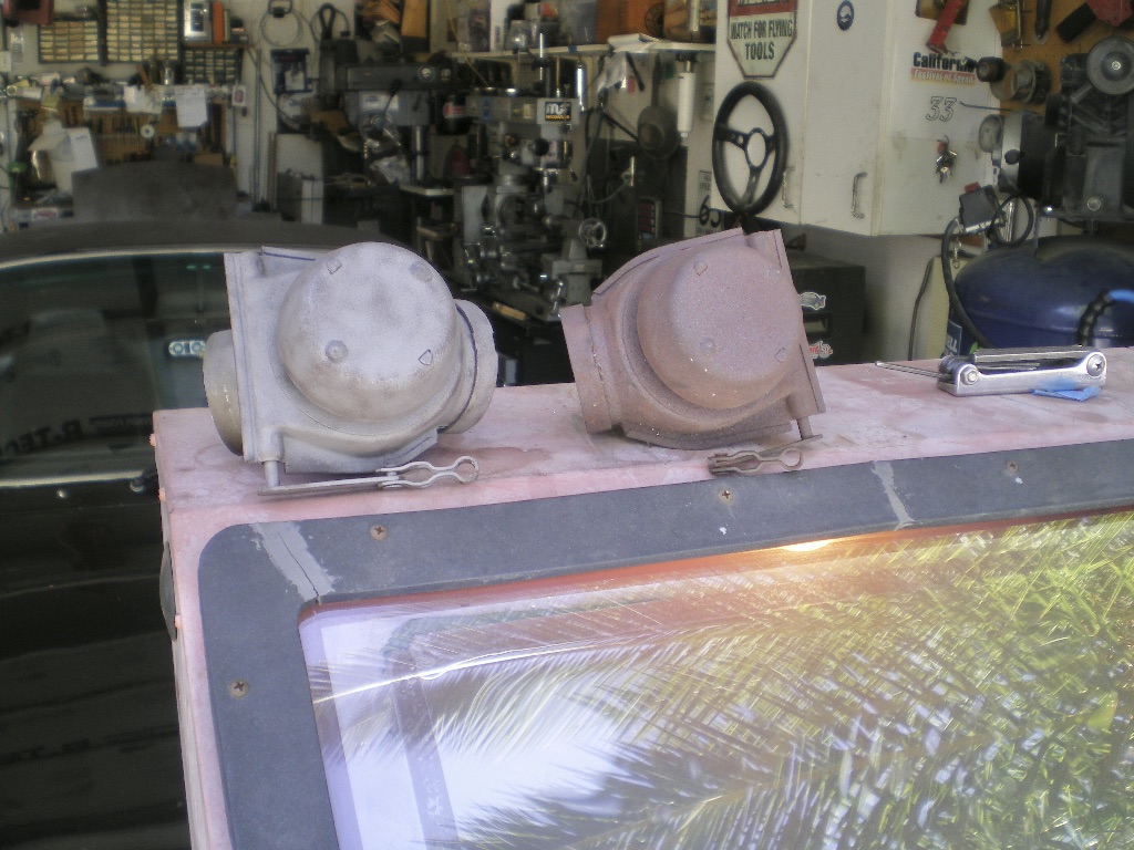

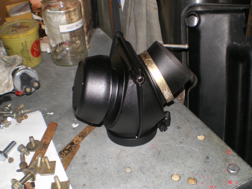

I got one heater diverter valve cleaned up before I decided I needed new media. It was taking too long so I'll change that out tomorrow. So only one got painted.

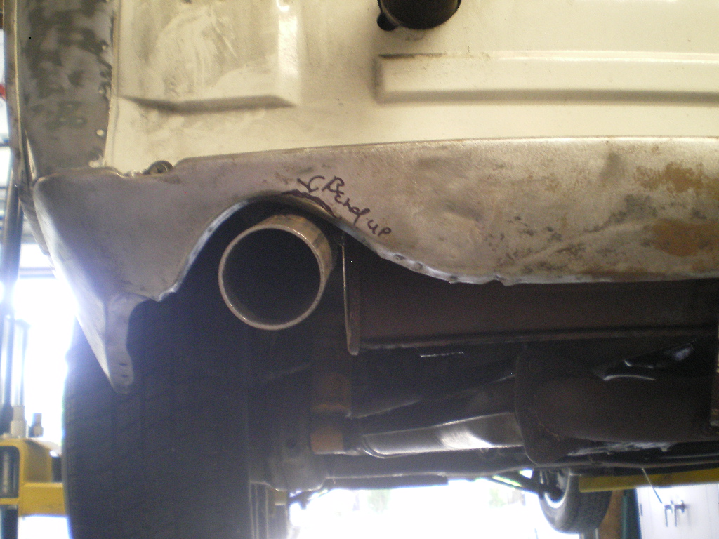

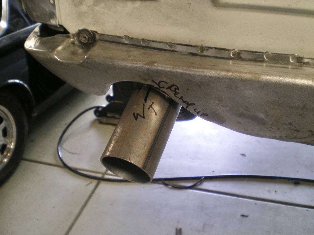

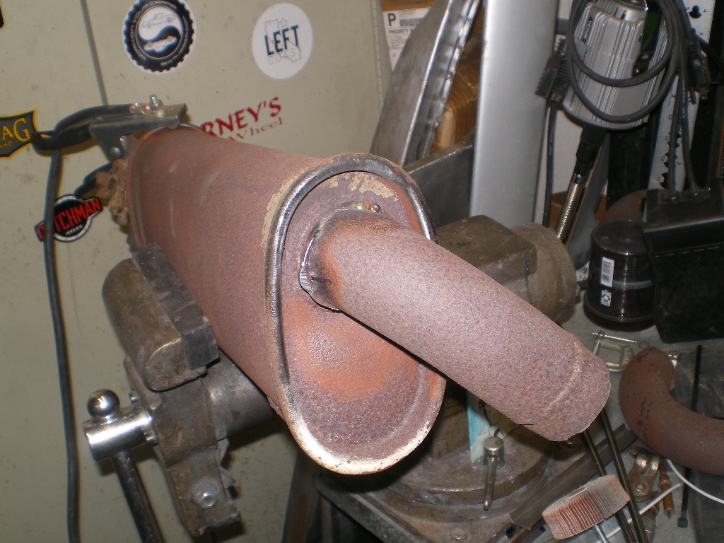

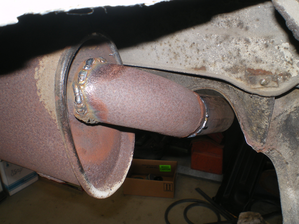

I was able to re-use the existing muffler with a little work. That God awful dual tip is Kaput and the proper single out tailpipe is in its place. I will cut it to final length and trim it a bit once the bumper is back on. It was a bit tricky cutting and re-welding the 90 degree fitting but everything came together.
