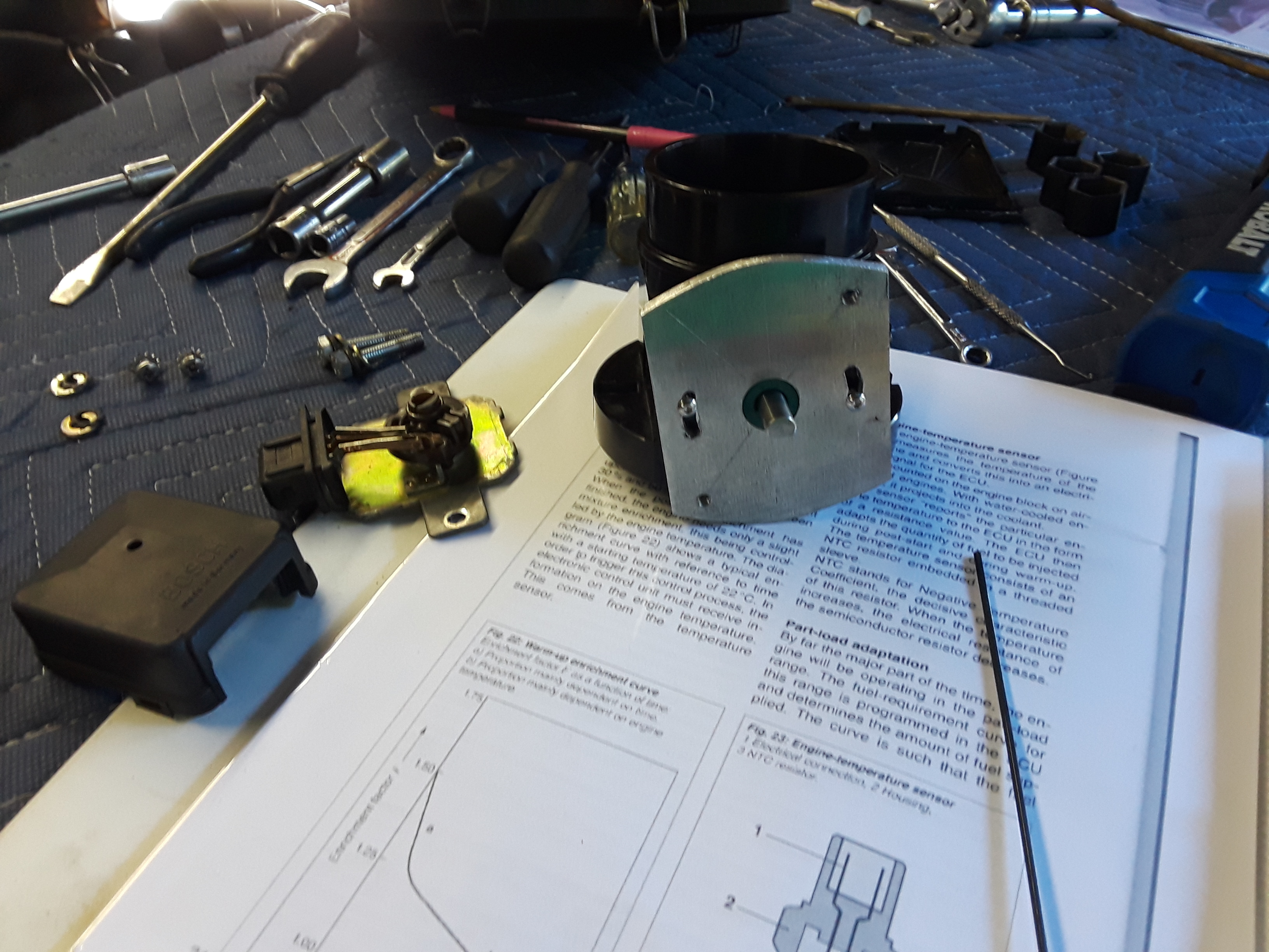

914werke   here's what Im working with:   Jul 1 2022, 03:00 PM
wonkipop   thats a 75 1.8 AFM. i believe it pairs with a 75 ...   Jul 1 2022, 08:45 PM
ClayPerrine   thats a 75 1.8 AFM. i believe it pairs with a 75...   Jul 2 2022, 06:24 AM
wonkipop   part #s / details for the L Jet components on a 91...   Jul 1 2022, 09:49 PM
wonkipop   @914werke some one who might be able to help wit...   Jul 2 2022, 07:56 PM
ClayPerrine   I don't understand why you would have to ...   Jul 4 2022, 08:10 PM
nihil44   Clay, I was just having a play with the Kombi AFM...   Jul 4 2022, 08:32 PM
wonkipop   thanks for the images @nihil44 great to be able...   Jul 4 2022, 08:40 PM
Van B   That ‘74 6 pin doesn’t look like either of min...   Jul 4 2022, 11:19 PM
