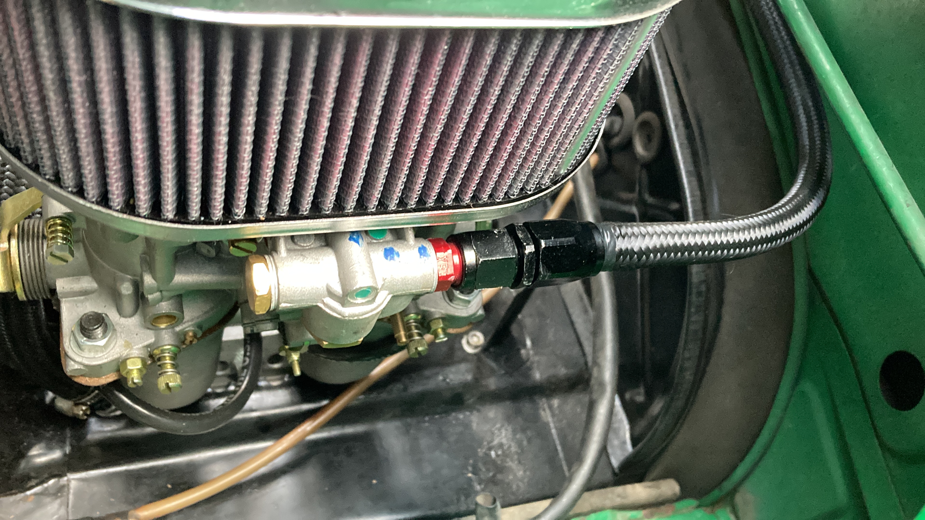

I also installed “AN fittings” (CB performance)
