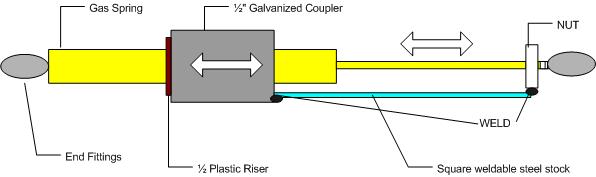

((((3))))
Release
Whats missing to make this work is a few pieces of metal that will ride on the Gas Spring and latch back where the cable release is.
So,
its one 1/2 inch galvanized coupler
(yes, the water type, and NO dont weld it till you file past the galvanized layer because its toxic)
There are lots of weldable 1/2 threaded couplers out there if you dont want the irrigation look.
Grind the coupler so a ramp is made from the back edge to the forward tip.
Optionally weld on the latch included with the kit.
SEE Diagram
Inside the coupler I found that a certain brown 1/2 riser (UPC 0 46878 37128 6)
(yes, for sprinklers) will just clear the Gas Spring and act like a teflon liner.
I cut off the rest of the riser and sanded the edges clean.
On the threaded tip I placed a nut and cut a lenght of square weldable rod.
Align the rod on the bottom and the ground ramp toward the latch.
CAREFULLY align the rod inline with agas spring jig with a small gap between them, and tack to the nut and the coupler.
DO NOT WELD NEAR THE GAS SPRING!!!
I used a failed Gas Spring as a jig so it would not explode.
(NOTE, do not push gas springs all the way in at any time! It will ruin them (IMG:http://www.914world.com/bbs2/html/emoticons/sad.gif)
Remove it from the spring jig and screw it onto the spring.
The rod should be on the bottom and the latch slope towared the outside of the car.
Testing still needs to be done to see if it rattles too much when closed.
