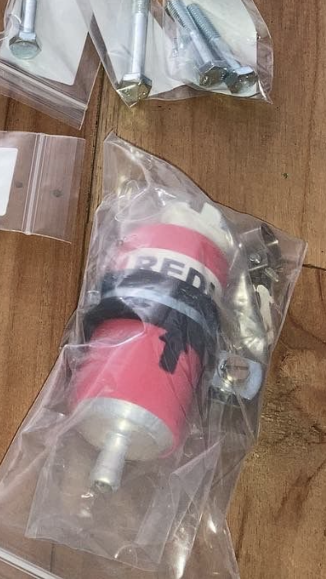

In my case I had no need for the regulator, I installed a redline fuel pump, good for 3 pounds of pressure. Its a tiny pink pump. No fuel return. Works fine, on my dual 44mm carb setup, I don’t know on a 6 cil, will need more, maybe yes.
I see various specs on that pump, some say 3–4 psi, some say 3–6 psi. Seems it is lower pressure than the Carter 4070 I have been using though. I think the range of pressure in the spec maybe is to do with the size of your lines. Currently I have 3/8" throughout so on the big side. I even machined a 3/8 fuel tank outlet to have no bottle necks. Could be a good option.
