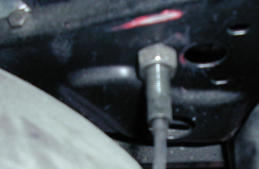

Drill out one hole and mount it with one screw/nut to the hole in the back cover. (See PIC)
The force of the gas spring will force it against the body.
It should be mounted as shown UNDER the lip for the best fit.

Pull mount, This has to be drilled and is the only change to the body.
