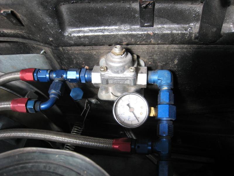

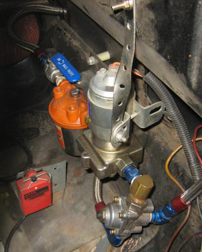

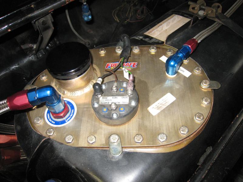

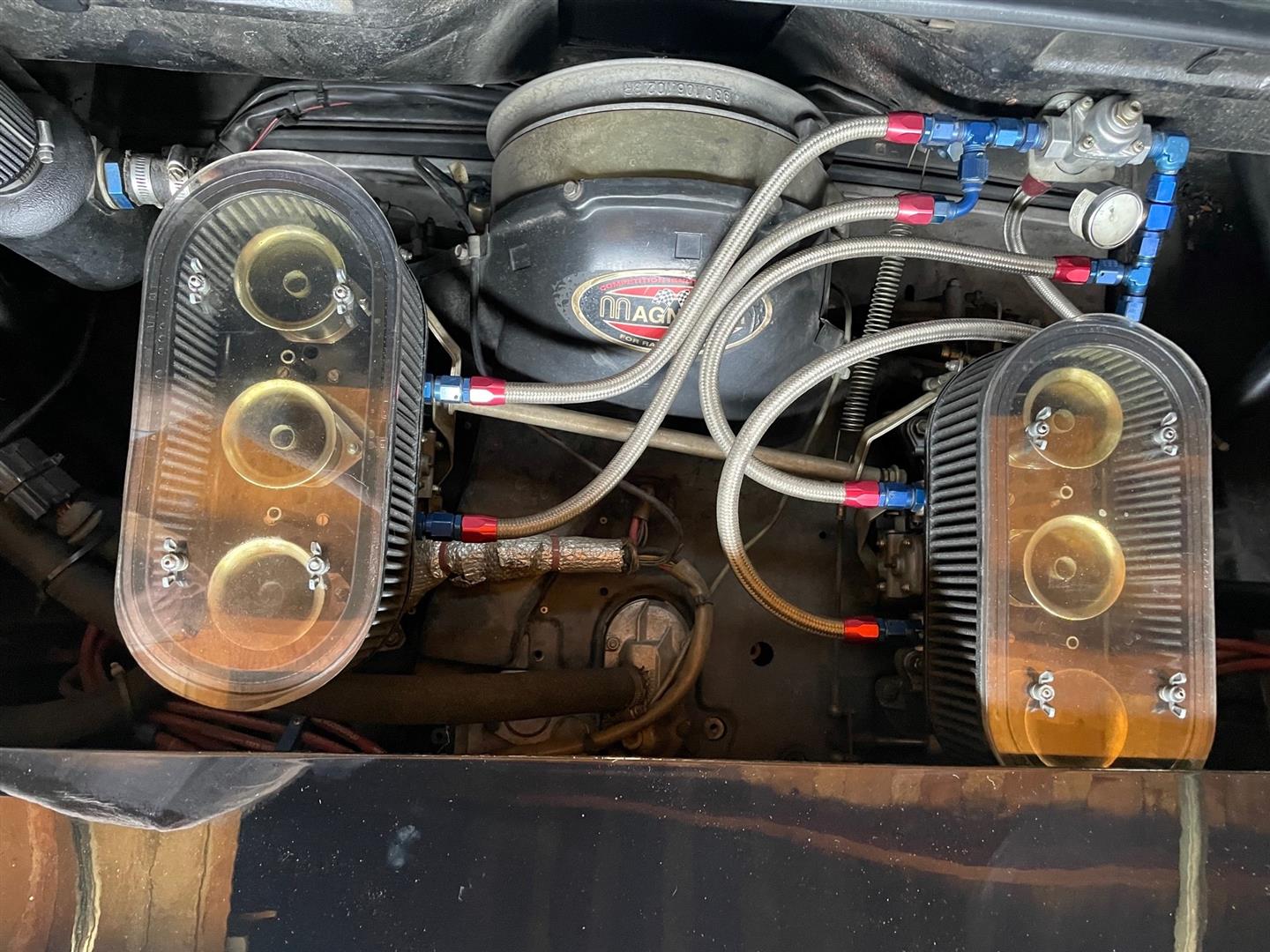

My configuration is:
  1. Tank
  2. Filter
  3. Pump
  4. Bypass regulator
  5. Low pressure regulator
  6. Carbs
I have a Holley Blue high-volume pump followed by this bypass regulator:
https://www.holley.com/products/fuel_system.../parts/12-803BP
The bypass ranges between 4-9 psi which is too high for my Webers so I have a low pressure regulator in the engine compartment. I'm using this one:
https://www.holley.com/products/fuel_system...rs/parts/12-804
My bypass line is in the frunk and dumps into the tank. This was to keep cool fuel flowing through the high-volume pump which would get hot during idle or low flow part throttle settings.
Attached Image Attached ImageAttached ImageAttached Image
