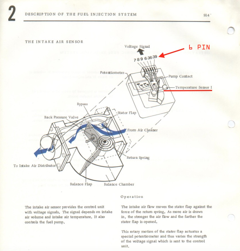

ok @StarBear .
i had to keep digging. as i do.
i think we do have a temp sensor I on the 74.
but its different to the 75.
i've never been inside my AFM.
so i'm going blind here off documentation and diagrams.
but as far as i can guess or surmise, its somehow inbuilt in our 74 AFM and it appears to have been separated out in the 75 units. perhaps in order that it can be replaced.
i think it is integrated into the potentiometer section of the AFM in 74 but it might have been shifted to another location in the 75 unit, more directly in the airstream.
i have never seen a 75 unit, and being down here, i never will.

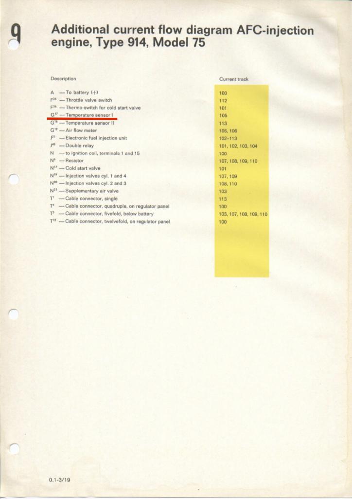

but here are the electrical diagrams from factory manual.
this would imply its not there in 74.
but not necessarily. it might be that its just considered an integrated part of the AFM potentiometer unit.
this is the 75 wiring diagram.
clearly says its there as a separate thing.

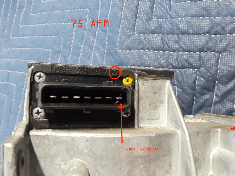

it has a dedicated pin too. 27.

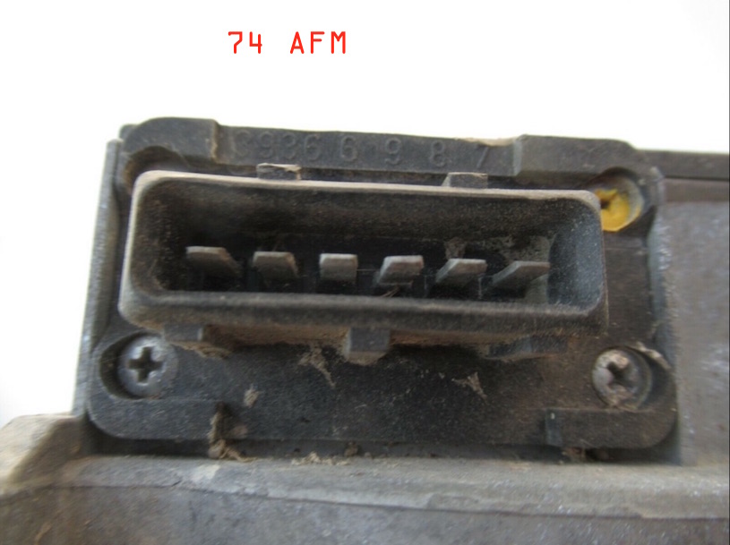

74 AFM. 6 pins. no dedicated pin.
75 AFM. 7 pins. 27 is a dedicated pin according to wiring diagram. hence additional pin.

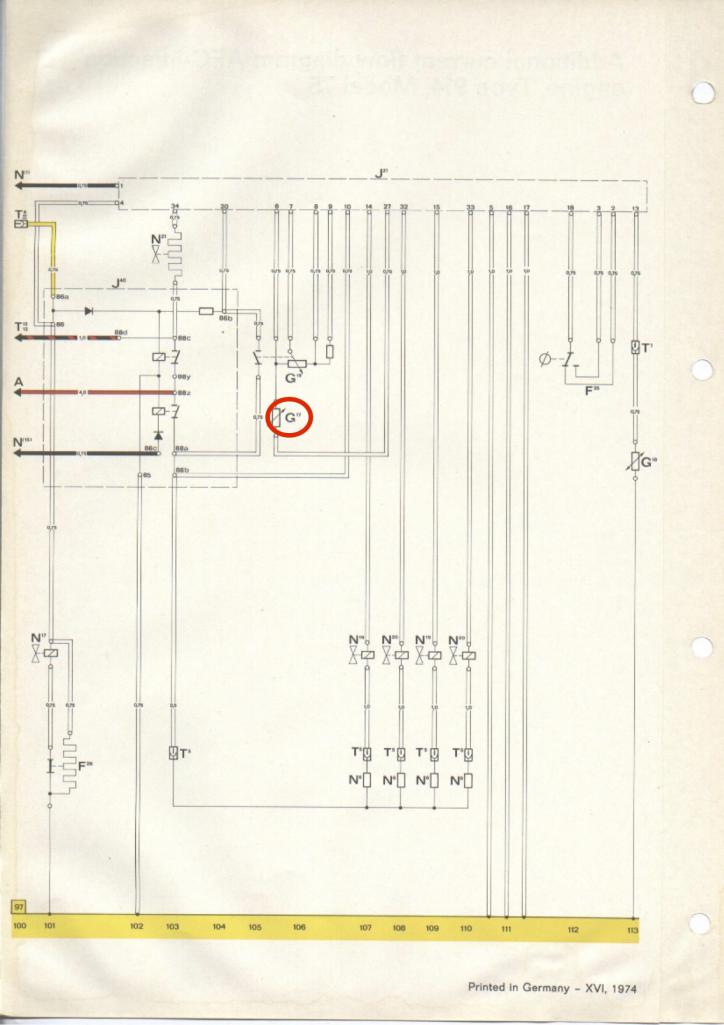

diagram page from factory workshop manual.
seems to imply the sensor I is there in 74 and is integrated part of potentiometer.
but is not in airstream.
of course it is a diagram. and i have never popped the lid to go in there and see.

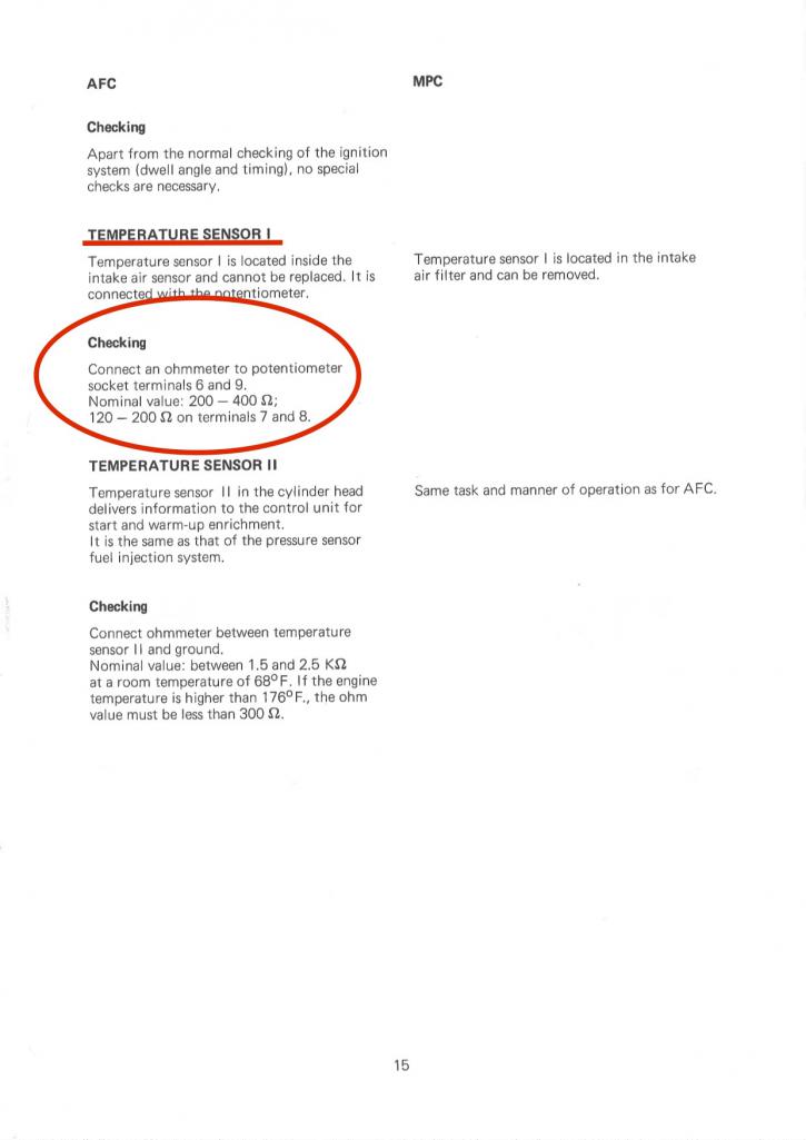

so.......maybe that training manual i downloaded from mr. b's site is not incorrect.
here is the page in question.
interestingly it tells you to test it using pins 6 and 9.
so i am thinking it is there.
but if it screws up in the 74 there is not much you can do about it.
(i leave this with @Van B - i think he has opened the lid on his to look inside). (IMG:style_emoticons/default/confused24.gif)
