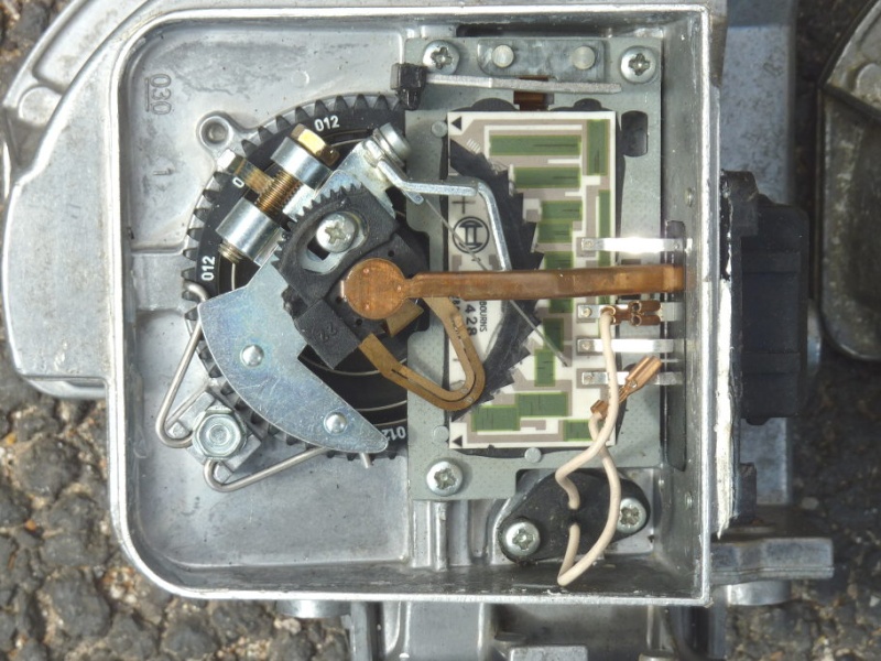

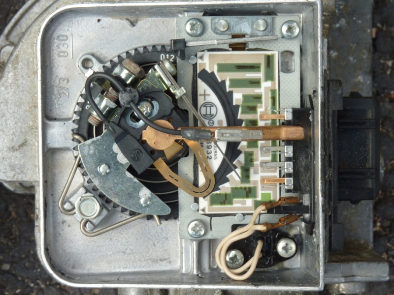

thanks for the image of the afm. cool. saves me murdering the pterodactyl perched on top of my engine.
i think i can see the two wires that go to it in yours.
here are a couple of good clear pics i dug up of an AFM off a BWM K100 forum.
an early one.
a later one.
i believe it is the thing in bottom right of AFM in images with a couple of wires to it.
i think it just gets wired in differently in the early AFM if indeed i am right about it being there. it looks like its replaceable in these later AFM. undo two screws. but its probably fused in to the unit in someway in ours and can't be replaced easily?
