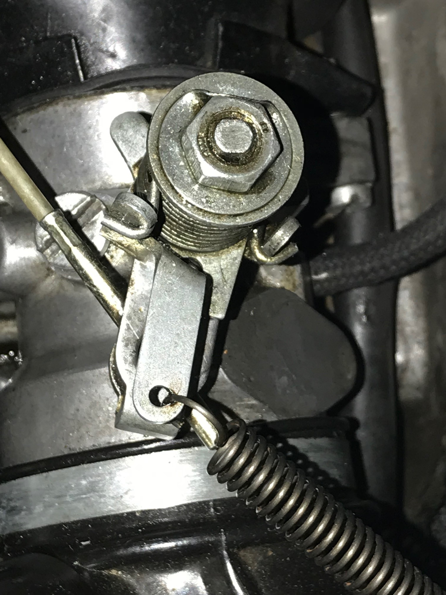

UPDATE #2:
1. Found the hose on the back (rear) side of the throttle body was a bit loose. Put some sealer on the nipple and put hose back on. Nice and tight now.
2. Found the lever connected to the spring (see pic) doesn't pull back all the way when not running; there's 2-3 degrees of play where the spring doesn't fully reset the lever backwards. Weak spring (replaced it only a few years ago) or sign of the worn throttle body? Shot in some silicone spray and will let soak in; maybe do another test drive this afternoon.
