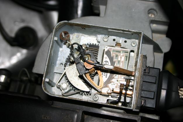

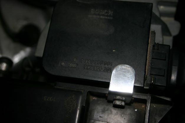

Apologies to the group for posting photos of what I believed to be the AFM from a 74. @Van B alerted me to the possibility that the photos were incorrect. I believed it to be a genuine 74 AFM as that was the AFM that came on the car when I got it.
I popped the top of the AFM which is on the car and indeed it is quite different inside. I don't know where the other AFM came from as the black plastic cap bearing the part number has been lost. Updated photos below. There are 2 black wires coming from the position of temp sensor ‘1’
I looked up PET and the change over point for the different AFM and ECU is the same – engine # ECO 037 551. 6 to 7 pin change over. No surprises there

nihil44   Apologies to the group for posting photos of what ...   Jul 5 2022, 06:00 PM
