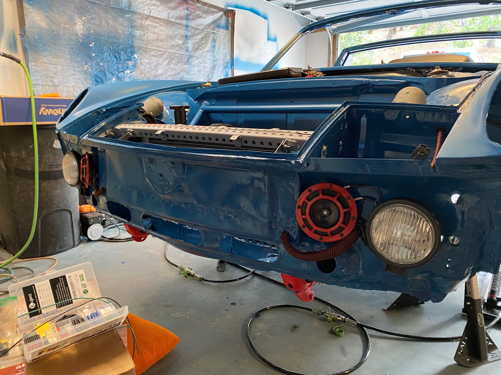

Awesome gauge cluster custom made for speedhut gauges. Thank you @tygaboy !! (IMG:style_emoticons/default/piratenanner.gif) (IMG:style_emoticons/default/aktion035.gif)
Installed Horns and fogs.

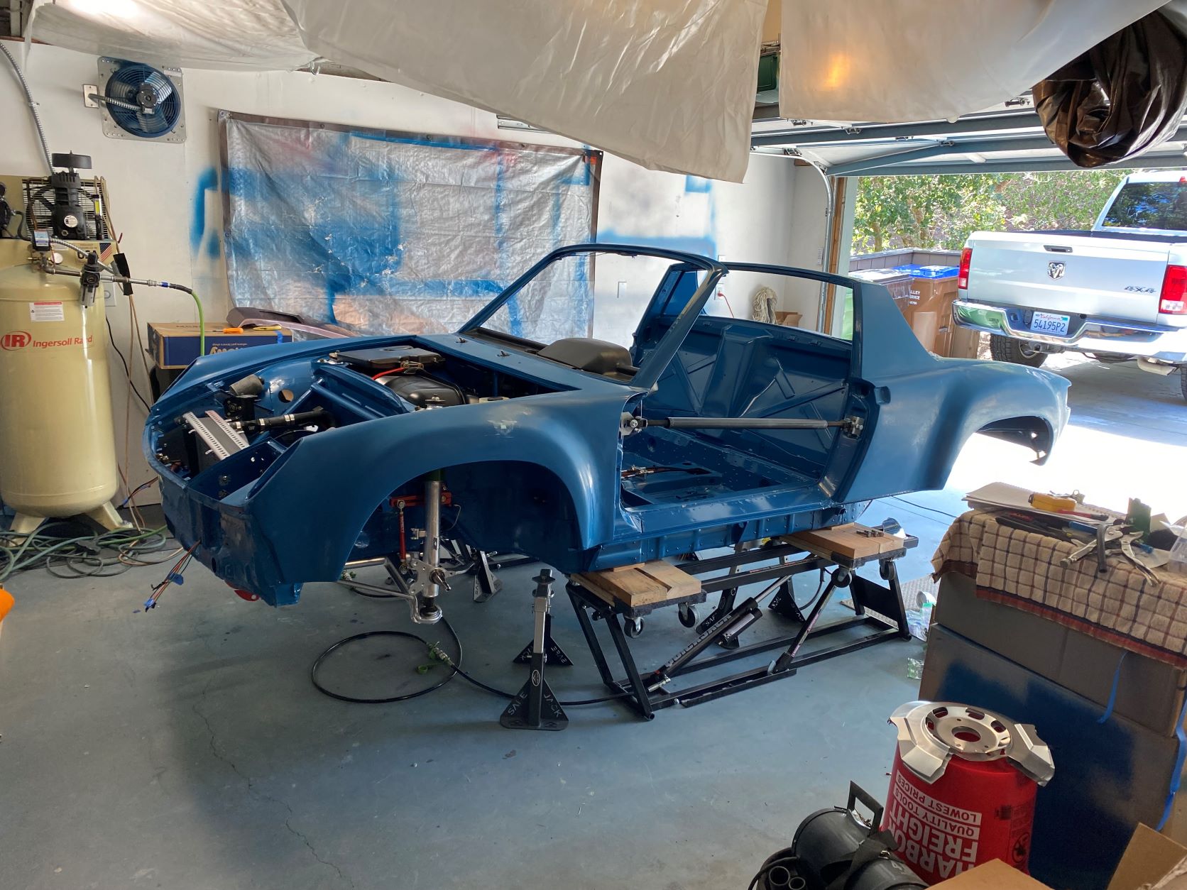

Engine and transmission is 95% ready for installation. Not sure if the air cleaner is going to clear, but I will figure that out during installation.
Would appreciate any solutions that does not involve cutting trunk metal.
Now if I can just figure out what kind of driveshafts I need, and how long. I think 19 3/4" but still checking on that.
If anyone knows what is needed between the 914 trailing arm, and a Subaru 5spd transmission I would greatly appreciate your thoughts! (IMG:style_emoticons/default/biggrin.gif)
This is my second JDM engine. The first one was a disaster - burnt valves and oil black as coal sludge. The new engine is a peach - practically new condition on inside with caramel color oil.
The car sits like this today. Next is rear suspension, brakes, and fitting hood, trunk and doors for a final coat of paint.
