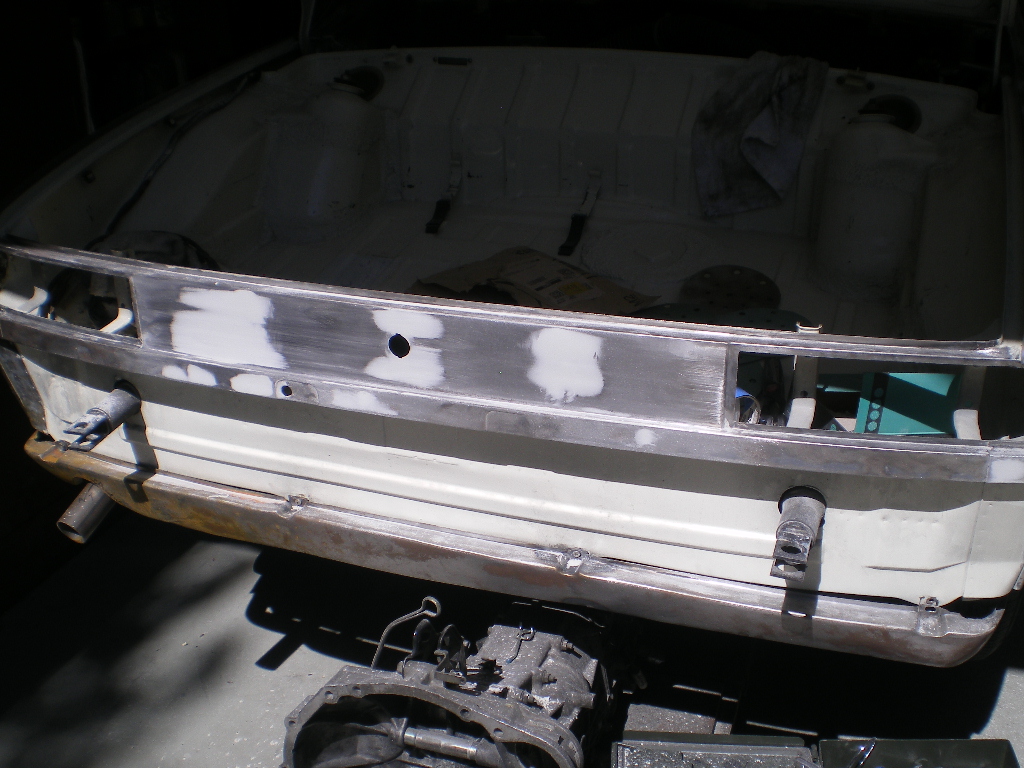

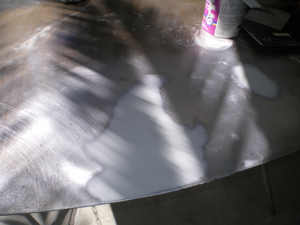

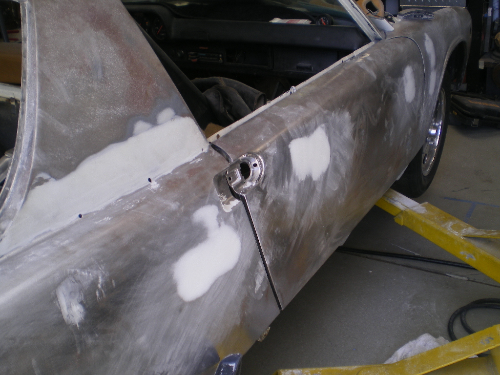

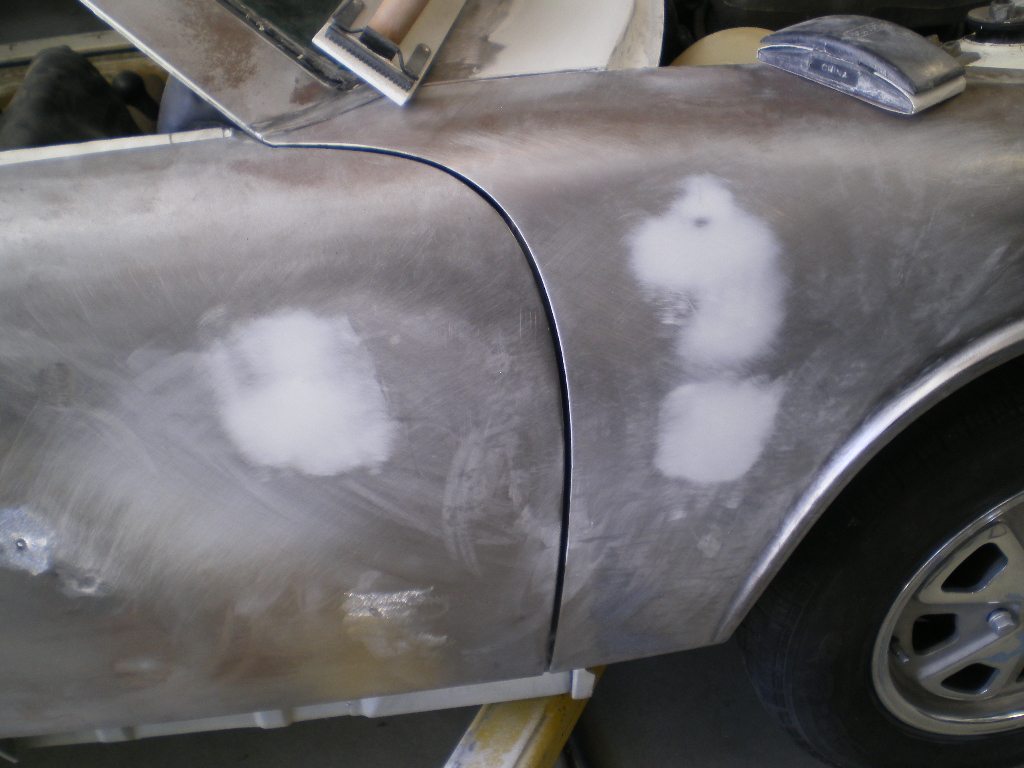

76-914   The 'Long Awaited" fun part has begun. ...   Jul 10 2022, 05:54 PM
