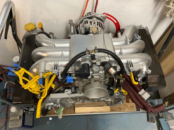

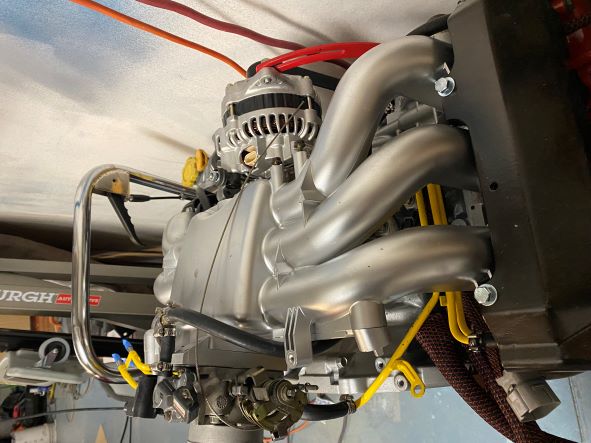

@76-914 yes, the engine is a EZ30D, with an EZ30R intake and full Jeff R reconfigured wiring harness and intake conversion plate.
I was going to flip the intake but then it does not appear that it would clear the alternator or the wiring harness would align the connectors.
I am open to suggestions! Thanks.

Are you keeping the AC compressor and power steering pump in place??? Post pic's of the harness dilemma. I thought that kit was made so that you can flip the intake and not cut the trunk???

@76-914 Sorry for the slow reply. I will not be using the AC compressor or the power steering pump. I might be able to leave the wiring harness. But, if I reverse the intake to face forward, I do not see how I will clear the alternator, and if the fuel rails/piping will clear the transmission housing. But the alternator seems like the real blocker.

would it be possible to rotate the alternator down in the bracket and get a smaller belt.
