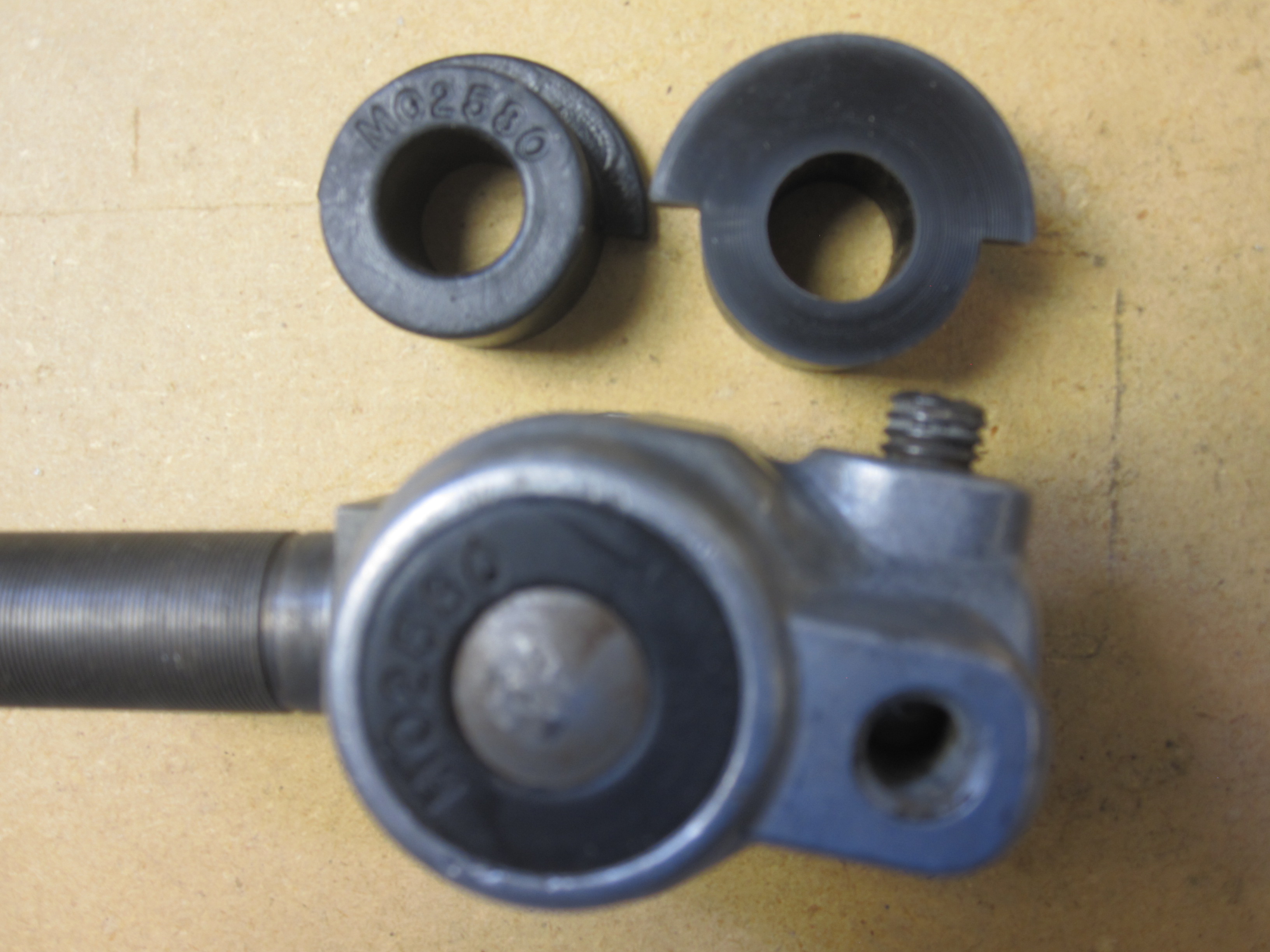

Hey Teeners, Just finished the shifter bushing in my SC and had great results. Figured I should do the BB as well to get some of the slop out. I started at the coupler and firewall, found the bushing had blown out and the coupler wasn't too bad. But since I had new bushings in hand I easily pulled the coupler apart and then found that the new bushings were not correct. The ID is way too large. Bought them from the local Porsche dealer in a weak moment of impatience. Parts bag shows 964-424-223-01. Ran the number on Pelican and their site says they are correct.
Please take a look at the photo and you'll see the problem.
Obviously I can;t cal anyone today but I'm wondering if anyone has seen this before?
The SC calls for a very similar bushing but it is a different part number, ending in 02.
My pin measures 12mm and the bushing ID is a bit over 13mm.
Thanks for reading this and any suggestions.
RobAttached Image

robkammer   Shift coupler question   Jul 24 2022, 09:11 AM
rgalla9146   There are two (now maybe three ?) versions of that...   Jul 24 2022, 10:15 AM
robkammer   That is the new bushing in the photo. From my expe...   Jul 24 2022, 11:00 AM
914Sixer   Yes, there is a bunch of crap out there. Stay awa...   Jul 24 2022, 12:09 PM
Mikey914   We have made a bushing that actually requires the ...   Jul 25 2022, 12:24 AM
930cabman   had my local machinist make all of the shift rod b...   Jul 25 2022, 04:57 AM
GregAmy   If you want to replace the bushings with a real jo...   Jul 25 2022, 05:57 AM
914Sixer   Another upgrade is to use the later 911 coupler mi...   Jul 25 2022, 08:28 PM
robkammer   Thanks Everyone. I have a set coming from AA, thei...   Jul 26 2022, 06:23 AM
930cabman   Thanks Everyone. I have a set coming from AA, the...   Jul 26 2022, 06:41 AM
Superhawk996   I cannot understand either, how can the factory s...   Jul 26 2022, 07:30 AM
bkrantz   I cannot understand either, how can the factory ...   Jul 26 2022, 08:33 PM
Mikey914   Hint - They don't make most of the parts they ...   Jul 26 2022, 03:10 PM
robkammer   Of course they don't Mikey. Hardly anyone does...   Jul 26 2022, 07:37 PM
Superhawk996   Of course they don't Mikey. Hardly anyone doe...   Jul 27 2022, 05:46 AM
rgalla9146   Back to the original question...... Is the orig...   Jul 27 2022, 03:53 PM
Superhawk996   Back to the original question...... Is the ori...   Jul 28 2022, 07:25 AM
Mikey914   The Originals were not round, but compress.   Jul 27 2022, 10:52 PM
dr914@autoatlanta.com   yes coupler bushings were shared with 356 911 912 ...   Jul 28 2022, 08:39 AM
robkammer   Hey Teeners, After waiting a week for parts and a ...   Jul 31 2022, 08:26 AM
rhodyguy   Who was the vendor? Old pin or new pin?   Jul 31 2022, 08:32 AM
robkammer   Who was the vendor? Old pin or new pin? AA, old ...   Jul 31 2022, 09:35 AM
rgalla9146   The originals on our 914s with side shifters were ...   Jul 31 2022, 11:34 AM
rgalla9146   Weltmeister at PartsKlassik   Jul 31 2022, 01:57 PM
robkammer   Good news finally! After the dealer bushings d...   Aug 5 2022, 10:52 AM
