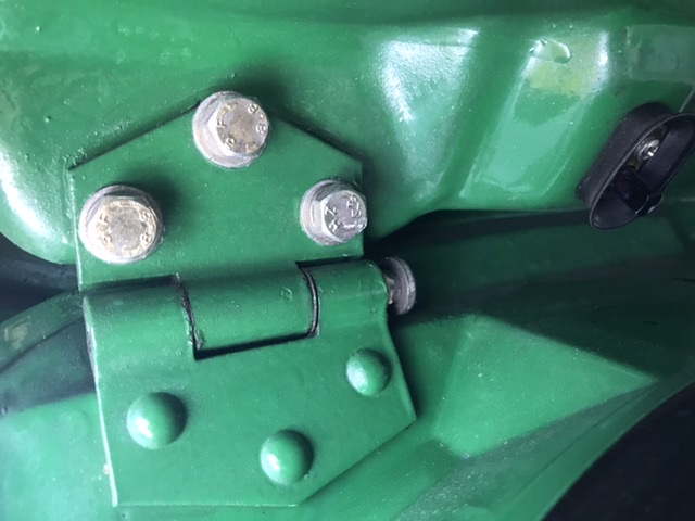

I have a 1972 1.7 that I’m restoring. One of the areas that I can’t find any information on is how the door hinges were originally finished. Mine have been sprayed over several times and when I repaint I want it to look right.
Were the hinges painted to the same color of the car? What about the bolts and pins. We’re they painted or zinc/cadmium plated. I ran my bolts through my ultrasonic cleaner and it appears they are black underneath the layers of paint.
Does anyone have an original picture of how it was finished from the factory?

Here are mine. Original and unmolested to my best recollection. Note zinc chromate bolts with 5F and 8.8 markings. Hinge bolts in opposing directions. Same on passenger side. Mid-early 74 1.8. Original owner.
Bolt head scratches do show signs of use.

mepstein   I’ve only seen painted.   Aug 3 2022, 06:18 AM
StarBear   I’ve only seen painted. Probably mine have bee...   Aug 3 2022, 06:39 AM
mepstein   I’ve only seen painted. Probably mine have be...   Aug 3 2022, 06:47 AM
StarBear   Oh, I may have changed them out many decades ago. ...   Aug 3 2022, 06:54 AM
mepstein   This is from the 27k mile car on bat. I’m not sa...   Aug 3 2022, 06:56 AM

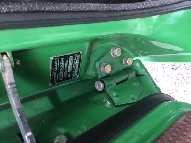

wonkipop   here is my karmann tag proper in focus. she is no ...   Aug 3 2022, 07:08 AM
StarBear   And remember - Hans seems to have worked on buildi...   Aug 3 2022, 07:15 AM

wonkipop   couple more 74s from research file.   Aug 3 2022, 04:37 PM
StarBear   I’m convinced by the data and pics provided. Min...   Aug 3 2022, 04:47 PM
