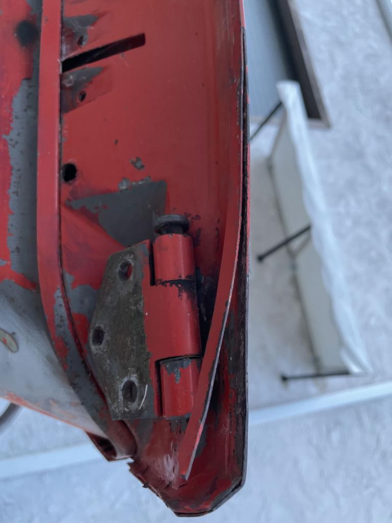

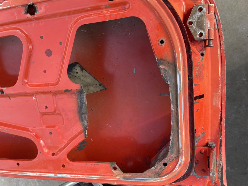

The car I've been working on is pretty early, 987th car built, November 69 chassis number. I'm working on the doors. I stripped the paint using Citrus Strip which doesn't take the original paint off very well, and the is no orange on the pins.
