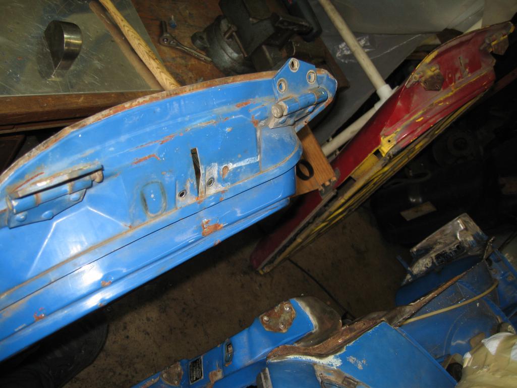

I have a 1972 1.7 that I’m restoring. One of the areas that I can’t find any information on is how the door hinges were originally finished. Mine have been sprayed over several times and when I repaint I want it to look right.
Were the hinges painted to the same color of the car? What about the bolts and pins. We’re they painted or zinc/cadmium plated. I ran my bolts through my ultrasonic cleaner and it appears they are black underneath the layers of paint.
Does anyone have an original picture of how it was finished from the factory?

QUOTE(mepstein @ Aug 4 2022, 01:56 PM) *
Some of the very early cars are quite different from even the later 70’s but then again, with the big speaker cutout in the door, who knows what else has been done to the doors on that car.
The doors appear to be original.
That door was painted 3 times after the factory — 1 time Tangerine, and then red and then a lighter red.
However, after stripping, the original orange paint was evident on the door bolts but not the pins which is consistent with rest of the cars shown in this thread (except the 6 that is highly suspect on account of it having overspray on the rubber seal).
One could say that any car could have had the doors taken off at the pins and the paint chipped off and then reinstalled. It's unlikely in my mind that plasma torch wielding car audio installers did anything to the door pins on this car (IMG:style_emoticons/default/biggrin.gif)

QUOTE(nathanxnathan @ Aug 4 2022, 03:09 PM) *
the blue six on previous page has blue paint around the edges of the hinge pin.
and there is SKL1's car.
definitely later 914s are not painted there.
there are enough real original condition cars to say that for certain.
its interesting re the earlier cars.
if they were when is the cut off?
original poster's question is for a 72. so if they were painted his might be in the zone.
got taught a lesson about using logic when it came to 1.8s and EC-A or B engines.
so shouldn't speculate.
but it might be a legacy of porsche involvement in having a 6 model.
something they wanted done. might co-incide with the end of the 6.
but you know. it could just as easily be a revision of assembly line procedure at karmann and have nothing to do with either VW or Porsche. (IMG:style_emoticons/default/biggrin.gif)

QUOTE(wonkipop @ Aug 4 2022, 03:26 PM) *
My 4/72 build date 72 was never painted (after the factory). The pins are unpainted, the door bolts are painted.
The later cars (my 72) have pointed end door bolts but my 70 and 71 have flat end "regular" door hinge bolts. Possibly this could indicate the doors were taken off then put back on at the factory, Idk.
