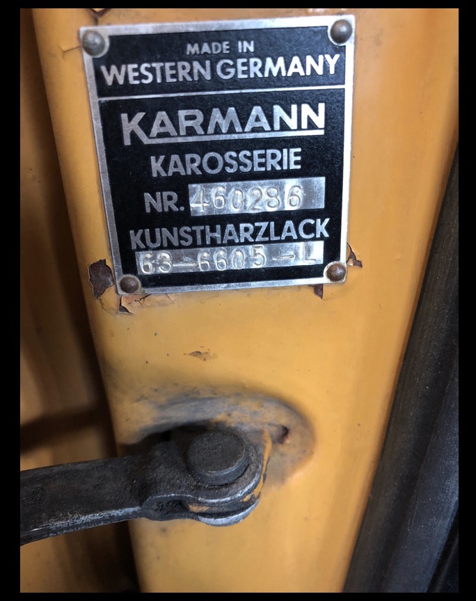

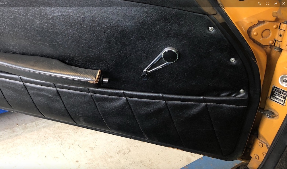

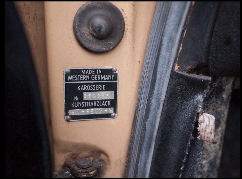

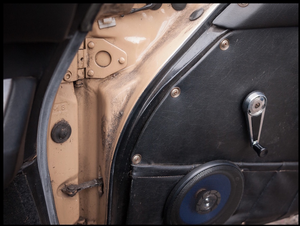

had a good look in 912 section of BAT.
managed to find a couple of cars that looked in the main unrestored with original paint on inners.
bit hard to find as most 912s have been restored, in some cases several times over.
looks reasonably certain that karmann were painting hinge pins in the 60s when doing these porsche bodies.
this one looks at first glance to be unpainted hinge pin, but close look you can see paint on edge of pin top.
