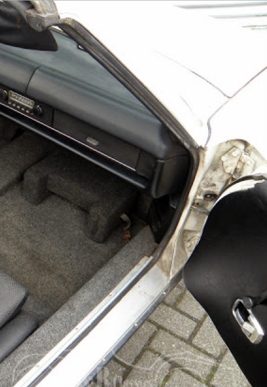

came across old ad for a 1970 914.
most of the paint looks original.
certainly all inners.
only one image is a clear shot of the hinges.
looks like the hinge pin could be painted in this early car.
hard to discern but think its white paint there not bare metal hinge pin.
