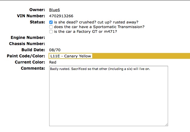

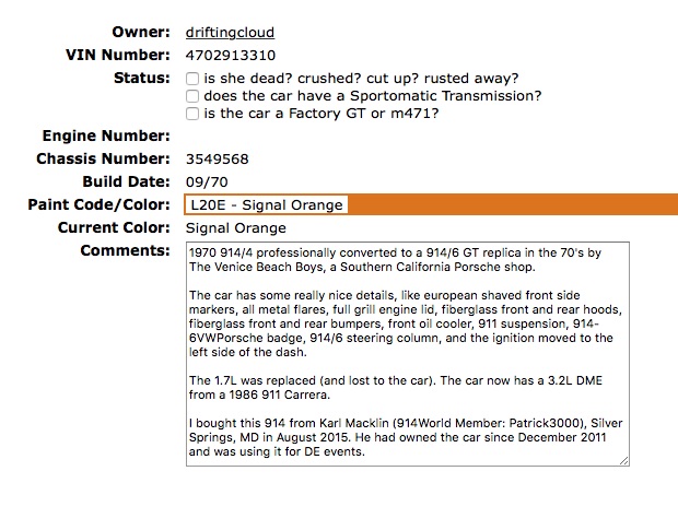

@nathanxnathan
i think i found the answer to the question about 70 models.
its there on this website in the members vin # listings.
they appear to be building 70 MY 914s as late as sept 1970.
unless members here were (IMG:style_emoticons/default/beer3.gif) when they entered their info?
how that works i do not know! (IMG:style_emoticons/default/confused24.gif)
germans!
