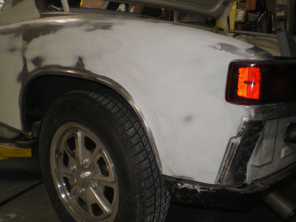

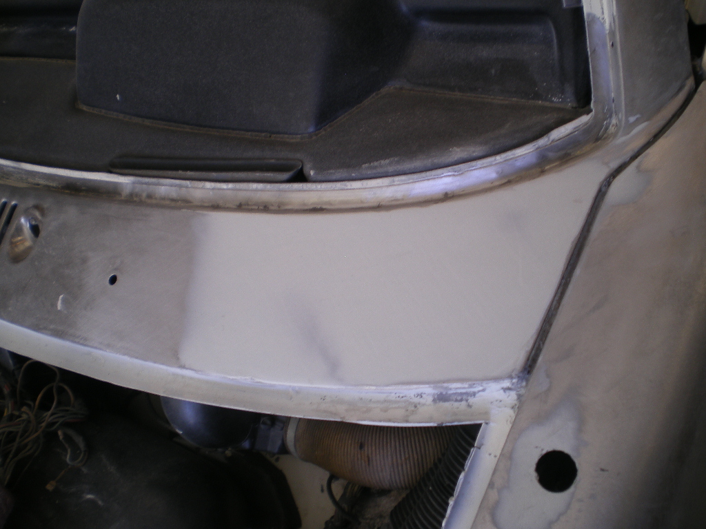

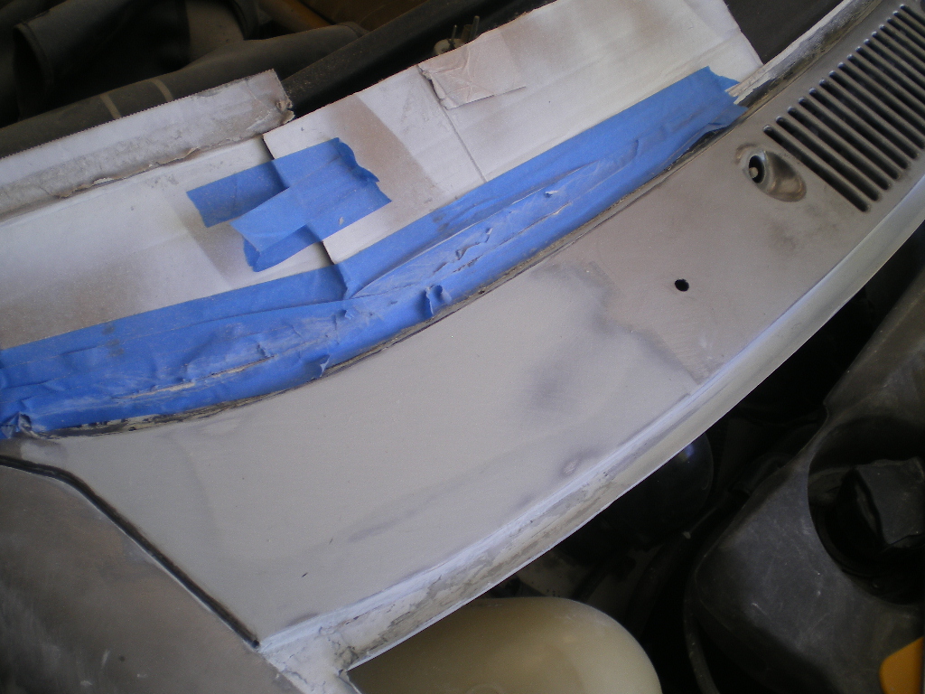

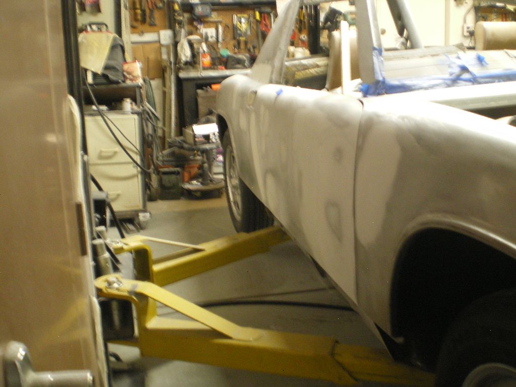

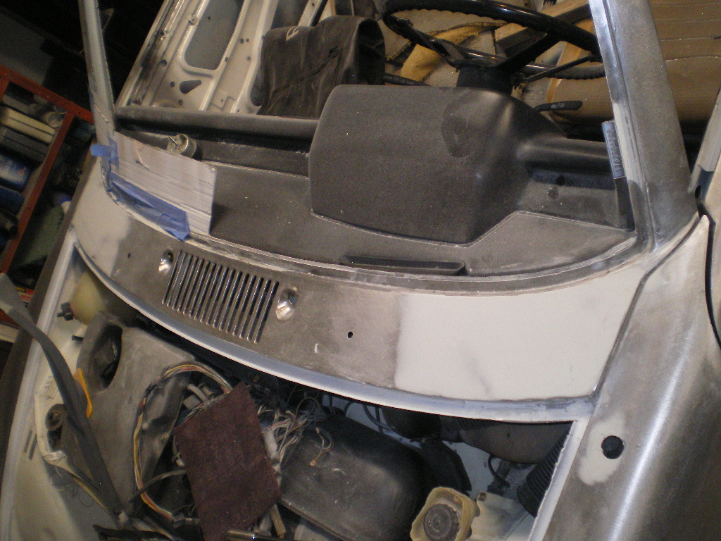

It seems as though I've been goofing off. Results are now minimal when compared to the progress made on the metal repairs. I am much closer to paint and the end of sanding body filler is around the corner.
Left side is finished sans some glazing putty.
Cowling is finished. Very happy that I didn't find any rust in the channels that separate the cowl and fenders. (IMG:style_emoticons/default/piratenanner.gif)

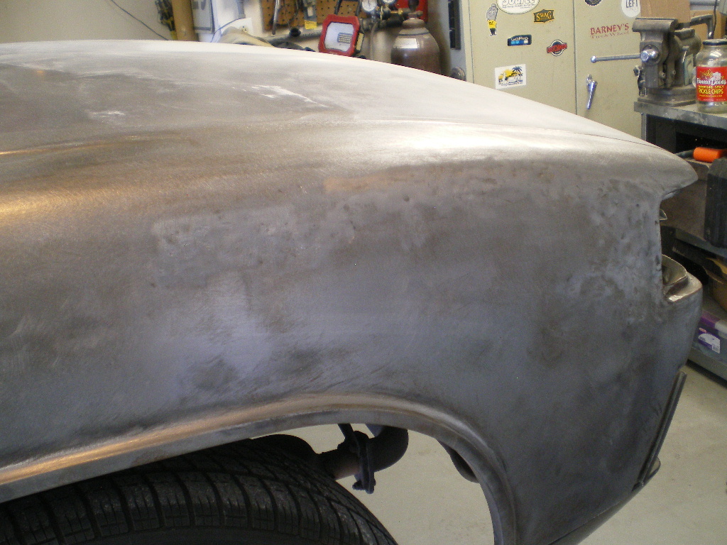

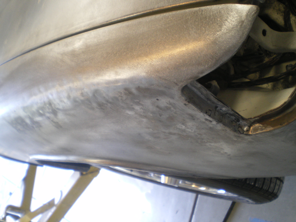

The left side required more work. I don't know if you remember how much work the quarter panel required just to get it to this point.
It took 3 separate attempts to get this panel smoothed out.
