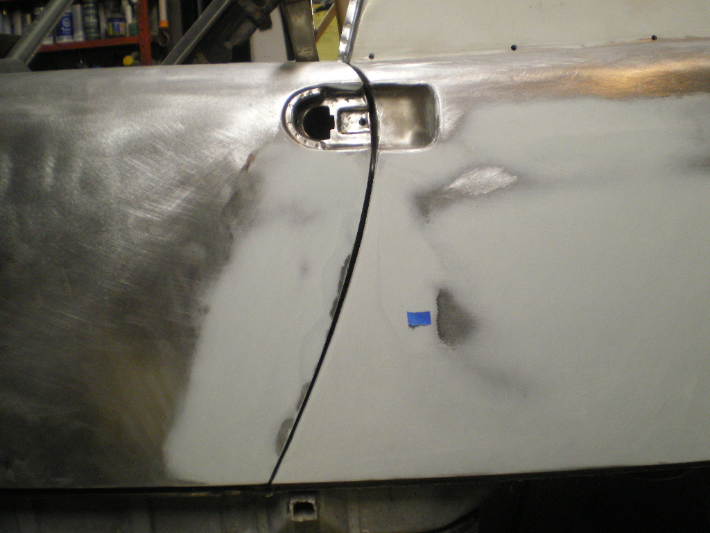

This door took me a few hours to hang it so that the gaps were uniform and even. I guess I can't expect these 50 yo cars to keep their figures after so many years.

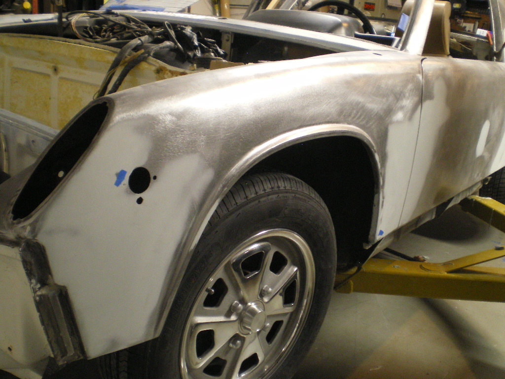

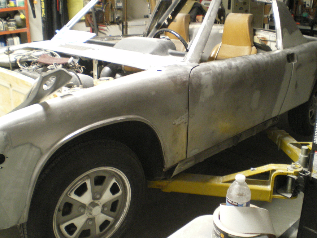

76-914   Left side is done. God willing and the creeks don...   Feb 1 2022, 10:31 PM
76-914   Dang, that took longer than I thought. Now I know ...   Feb 3 2022, 08:54 PM
Chris H.   Nice work Kent! Don't see any distortion ...   Feb 4 2022, 08:24 AM
76-914   Thx Chris but there is a little shrinkage at the w...   Feb 5 2022, 06:46 PM

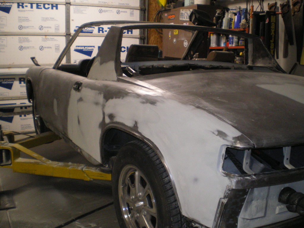

76-914   I couldn't sleep thinking about those low spot...   Feb 9 2022, 08:26 PM
bkrantz   OCD and 914--a dangerous combination. Ask me how ...   Feb 9 2022, 08:45 PM
76-914   OCD and 914--a dangerous combination. Ask me how...   Feb 9 2022, 09:38 PM
