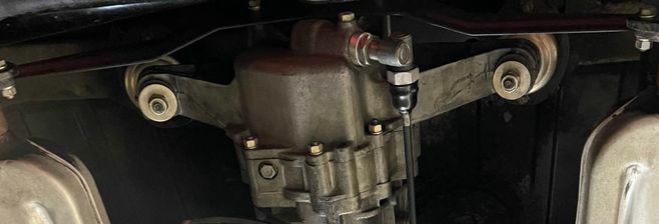

You only need to loosen it enough to slip the mount and long bolt out of the channel on the transmission support bracket. Remove the two bolts/nuts holding the mount to the chassis, loosen the long bolt from the mount to the transmission and take out the whole thing. Then install the same way.

QUOTE(Van B @ Aug 17 2022, 06:34 PM) *
Ah, but I think (?) the problem is that there's no headroom to slip the center bolt up that far - only an inch, tops. Mine looks like the pic below, from another current thread.
Haven't planned to hijack your build thread out of confusion and need, Van, so I apologize.
Yes, @wonkipop - but I'm not planning to do that anytime soon. Needs to be done (120k mi), but not urgent though may be the source of the little hum/vibration I get in 4th/5th gear on the highway, hence the idea to replace the mounts as perhaps a faster/cheaper solution attempt as they're the original mounts.

Van B   You only need to loosen it enough to slip the moun...   Aug 17 2022, 04:34 PM
StarBear   You only need to loosen it enough to slip the mou...   Aug 17 2022, 05:30 PM

wonkipop   @StarBear - you undo the 2 smaller M8 bolts on e...   Aug 17 2022, 05:42 PM
StarBear   [b]@[url=http://www.914world.com/bbs2/index.php?s...   Aug 17 2022, 07:53 PM
Van B   No worries @StarBear . You’re over thinking it....   Aug 17 2022, 05:59 PM
