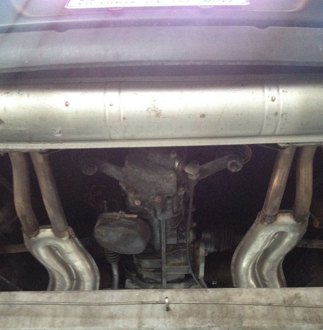

i'll explain why. its coming back to me because i ghosted these forums when i was recommissioning the wallaby 3 years back and read it all in some long lost thread here were a bunch of guys went at each other about those mounts.
1)
mine were on apparently "upside down". ie nuts at bottom bolt facing down.
photo before we started work. you can see them.

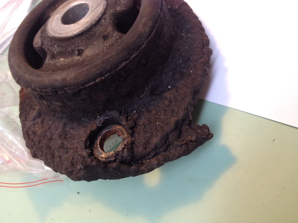

2. here is the top of the mount we removed.
still liberally goobered with original undercoating that got sprayed all around in there by some kook toking on a stoobie back in 74. it had never been off. the evidence was fairly compelling.
so the mounts before we started where "upside down" and had been so called "upside down" since the day it was built. 99% certain on that.
granted. some stoned german could have screwed it up the wrong way on the assembly line. or they dropped the motor in the workshop before they sold it new or sent it off to the undercoaters for some reason. but i very much doubt it.
additionally if you look through the factory manuals there are photos of the mounts in question in situ in the car with the nuts on the bottom.
so.....if you ask me yours are not upside down at all.
