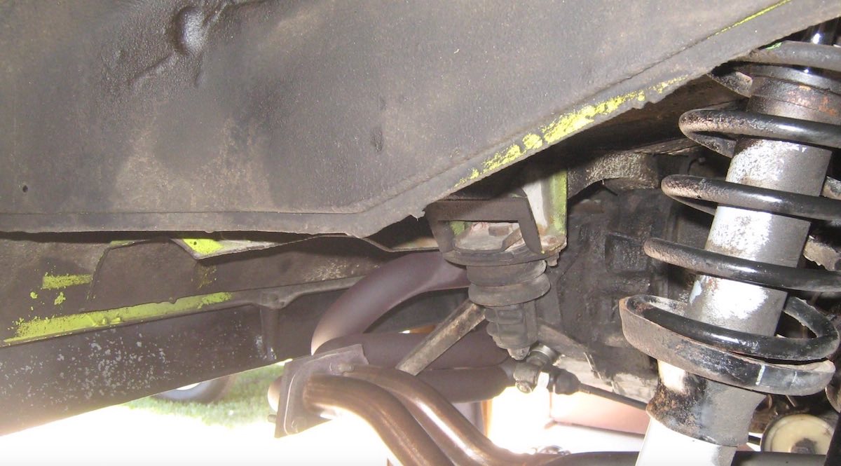

this might also give you pause to think @StarBear before you fret to much about those bolts.
from the L jet files.
44 K mile car we pulled down material on from BAT last year that was a big clincher for the 1.8 L jet research. sold back in 2016. just about one of the best most original 1.8s i've come across documented. Big Len would probably agree with me. you would be hard pressed to question this one.
to me don't look like anyone has been near the trans mounts since abba entered eurovision. they are "upside down" according to 914 myth. or are they?
this is from the alleged 29K mile blue car.
don't think it was 29K miles but along with Big Len i don't share everyone's else's scepticism about it and dismissing it as a 129 K car either. not as compelling as the green car.
but......they are "upside - down".
i didn't give ground on the charcoal can plumbing and its not that i was right about it.
but my car (as an artefact) was right. same with the plumbing on throttle bodies and dist vac cans. not saying i am right 100% here, but i'm not falling for the "rules" either.
i'm calling this one as problematic in terms of what the "experts" say.
have hijacked enough, but i think Van likes it when we get into a bit of heresy at his expense. those cold start threads he started up were some of the best explorations of 1.8 misery ever. (IMG:style_emoticons/default/dry.gif)
