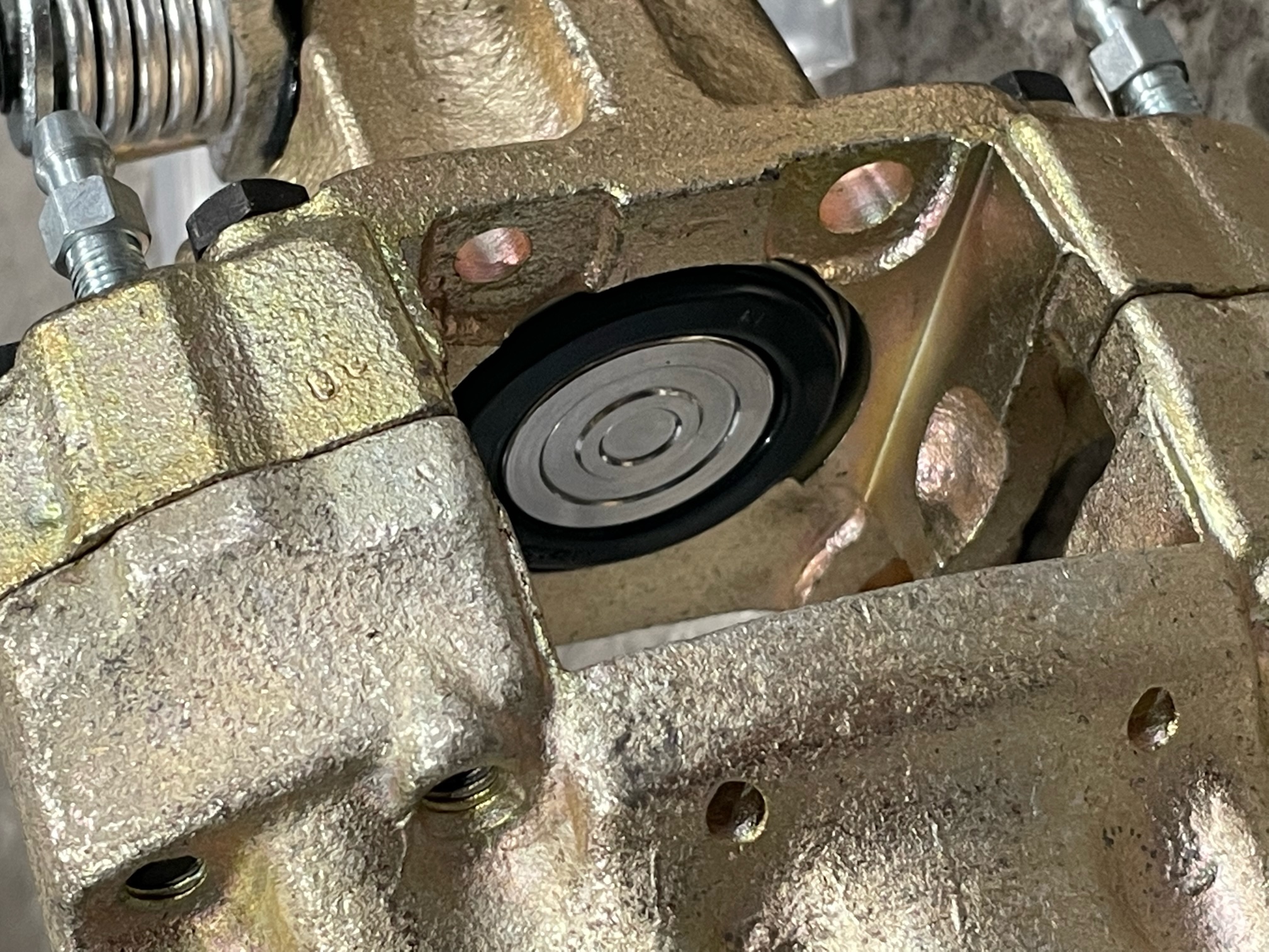

Very disappointed when I received 2 rebuilt calipers and one obviously had some considerable corrosion before being restored. After cad plating it looks like a gold nugget. The pad resting areas are extremely pitted and uneven. Pads move a lot more in the caliper than in my original calipers. Will this lead to any issues if I decide to use them?

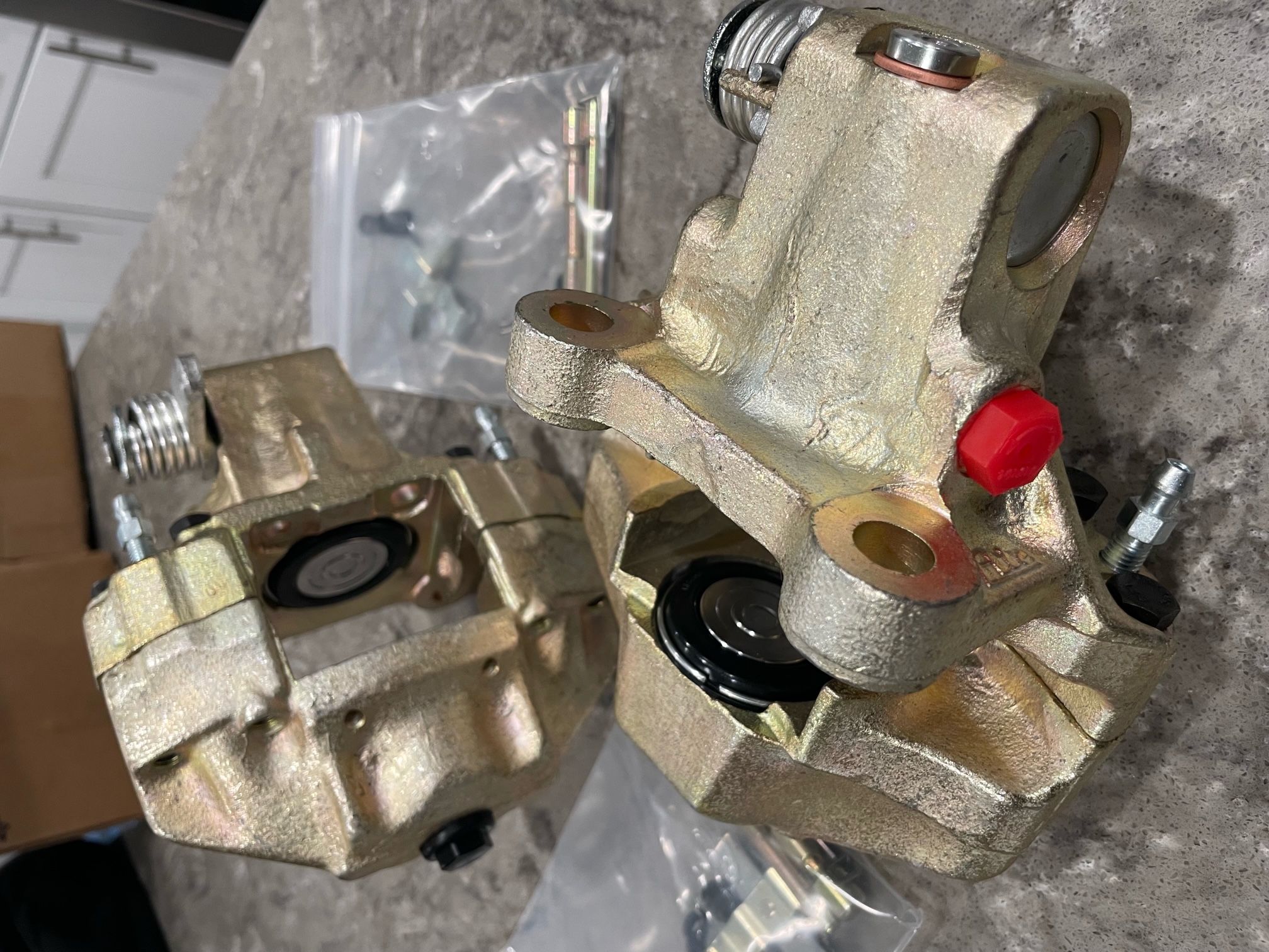

Today UPS delivered a box of calipers I ordered from a different supplier that I had found locally. Just opened the box and I can honestly say these are what I expect from a rebuilder. They are cad plated and the machined surfaces are just as they should be. They have “new” chrome pistons and came with all new hardware, pins, clips, bleeders, caps and retainers. They look brand new. The owner Pat is great to talk with and has tremendous knowledge regarding braking systems. I must have talked with him for almost 45 min before committing to order. I am glad I did and want to give a shout out to Pat and his skills.

sechszylinder   Very disappointed when I received 2 rebuilt calip...   Aug 16 2022, 02:57 AM
930cabman   From what I can tell the area in question is a sli...   Aug 16 2022, 05:45 AM
914Sixer   I would be worried about metal fatigue on the pin ...   Aug 16 2022, 06:01 AM
BillJ   I never ever mess with less than perfect with the ...   Aug 16 2022, 06:07 AM
PatMc   That’s trash.   Aug 16 2022, 07:18 AM
mepstein   There might not be a functional issue but I would ...   Aug 16 2022, 07:23 AM
SirAndy   :sick:   Aug 16 2022, 09:58 AM
Root_Werks   Wouldn't use it either, there are still good c...   Aug 16 2022, 10:03 AM
krazykonrad   Just as the tree is coming through your windshield...   Aug 16 2022, 10:50 AM
Brian Fuerbach   I will try to exchange it or just return the compl...   Aug 16 2022, 11:08 AM

Brian Fuerbach   Hardware   Aug 18 2022, 07:50 PM
barnfind9141972   Hardware Pat is the man, I have front and rear c...   Aug 19 2022, 02:16 AM
PatMc   Hardware Pat is the man, I have front and rear ...   Aug 19 2022, 12:05 PM
Brian Fuerbach   Hardware Pat is the man, I have front and rear ...   Aug 19 2022, 02:08 PM
rjames   The new ones look great! I love seeing that n...   Aug 19 2022, 04:06 PM
Spoke   Your latest set looks great. The first set looks l...   Aug 19 2022, 04:08 PM
Brian Fuerbach   Your latest set looks great. The first set looks ...   Aug 19 2022, 07:34 PM
