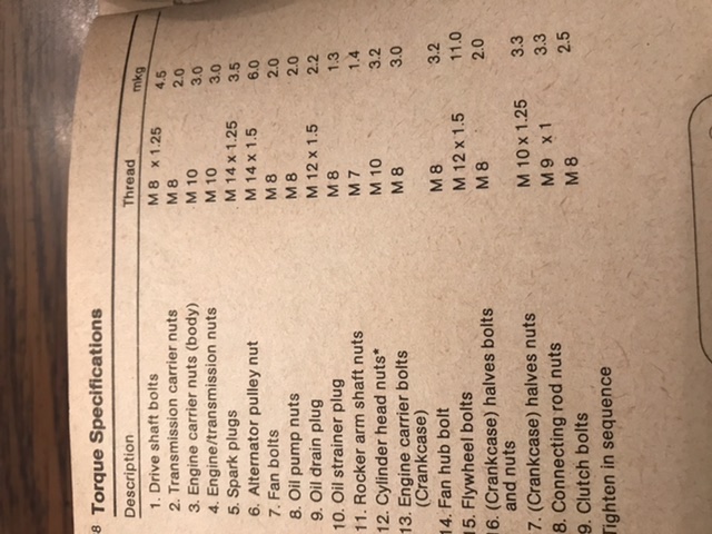

Van; would these be the torques you mentioned? #2 Not specific to the center bolt?

StarBear   Van; would these be the torques you mentioned? #2 ...   Aug 19 2022, 03:13 PM
Van B   Steve, for the life of me, I can’t find the M12 ...   Aug 19 2022, 05:09 PM
StarBear   :cheer: :Qarl: :beer2: Onward! Thanks and b...   Aug 19 2022, 05:35 PM
