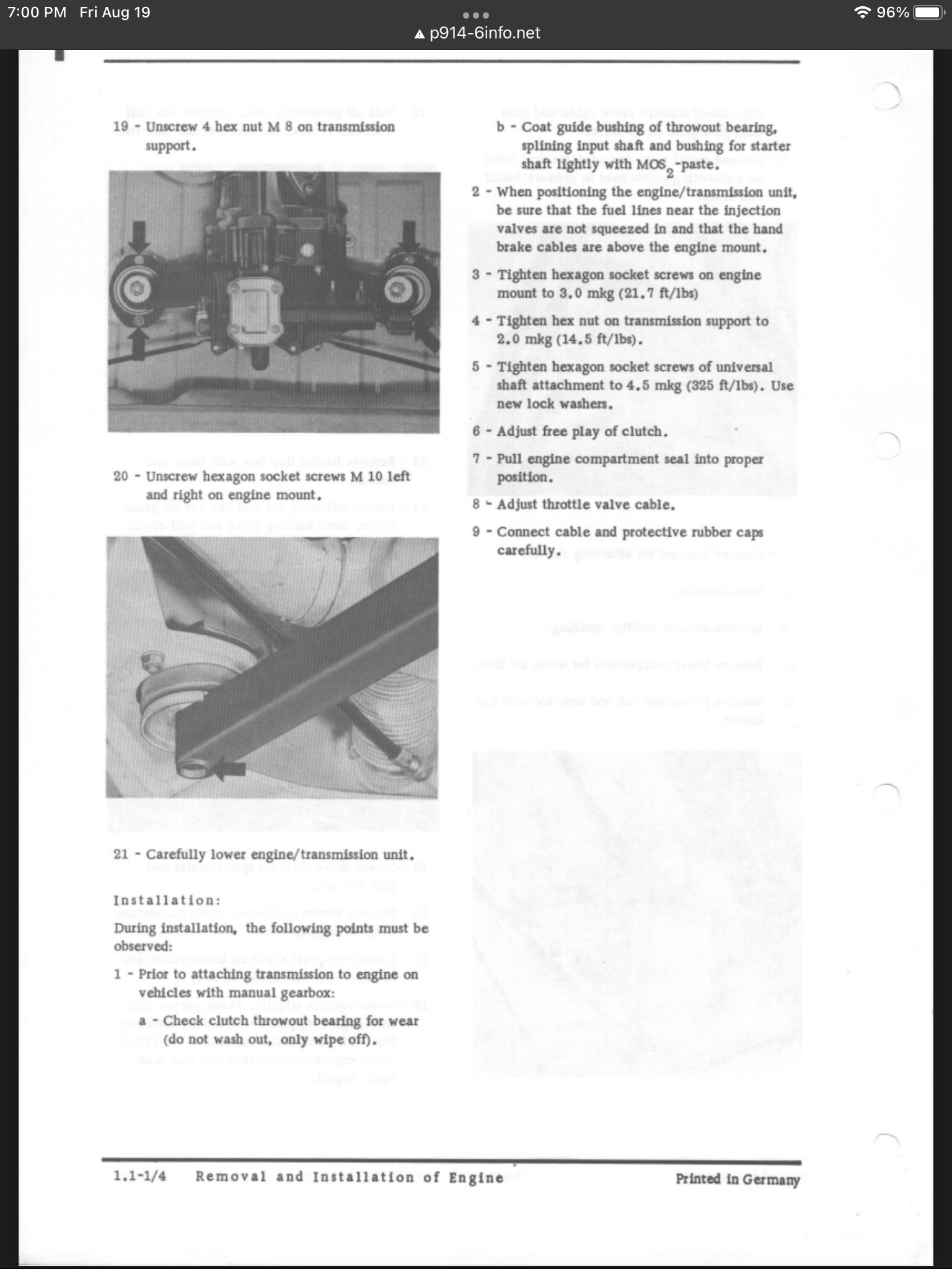

Steve, for the life of me, I can’t find the M12 bolt reference. But, I use charts like this when I need a standard spec for grade, size, pitch: https://www.fastenermart.com/files/metric_t...ten_torques.pdf
So, ~40ft-lbs is a safe bet for the long bolt unless you can confirm the grade as higher than 5.
The small M8 carrier bolts for the transmission mounts are listed in the engine section attached.
Oh and Wonki, I can’t possibly complain about one of the few guys who responds to my cries for help lol! (IMG:style_emoticons/default/beer.gif)
