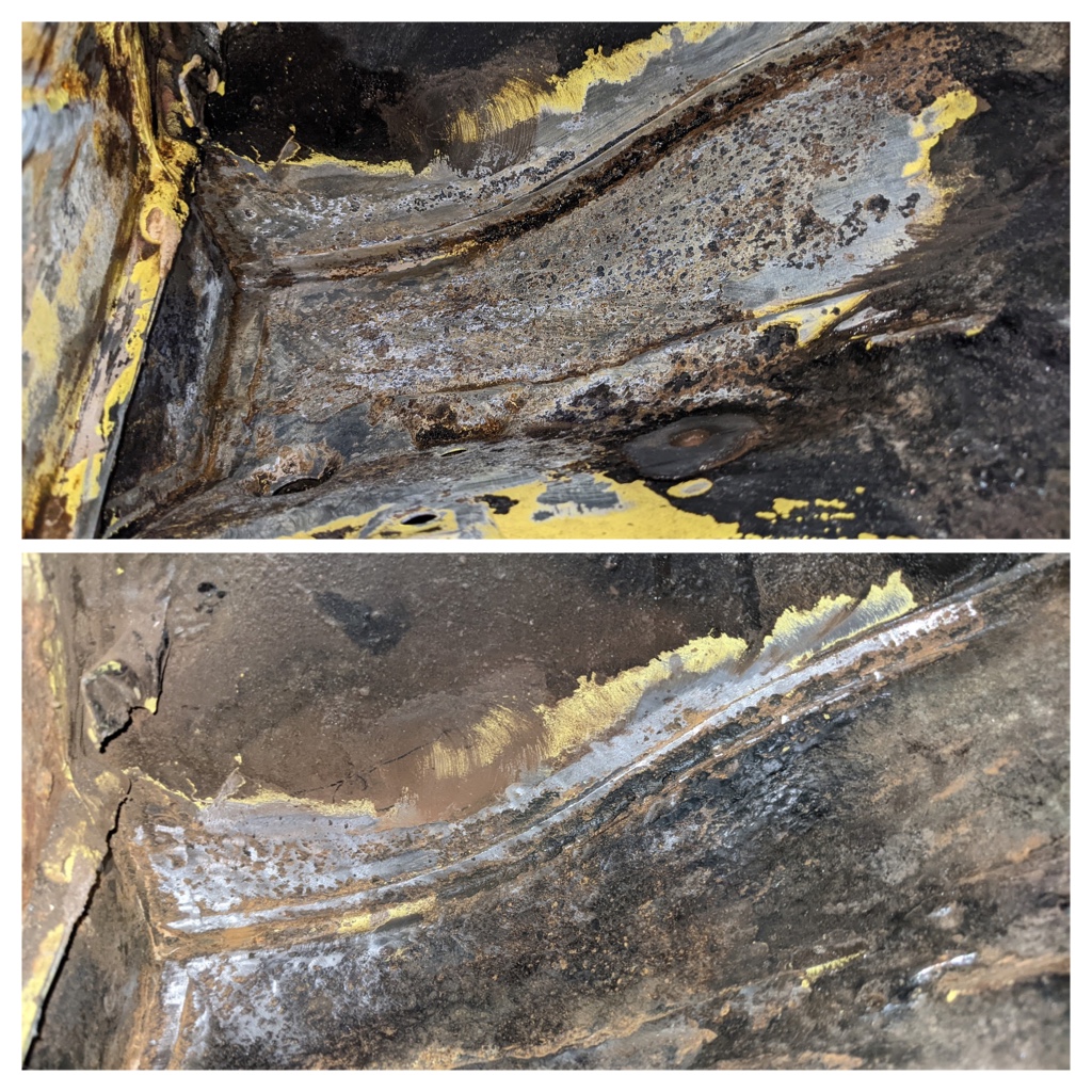

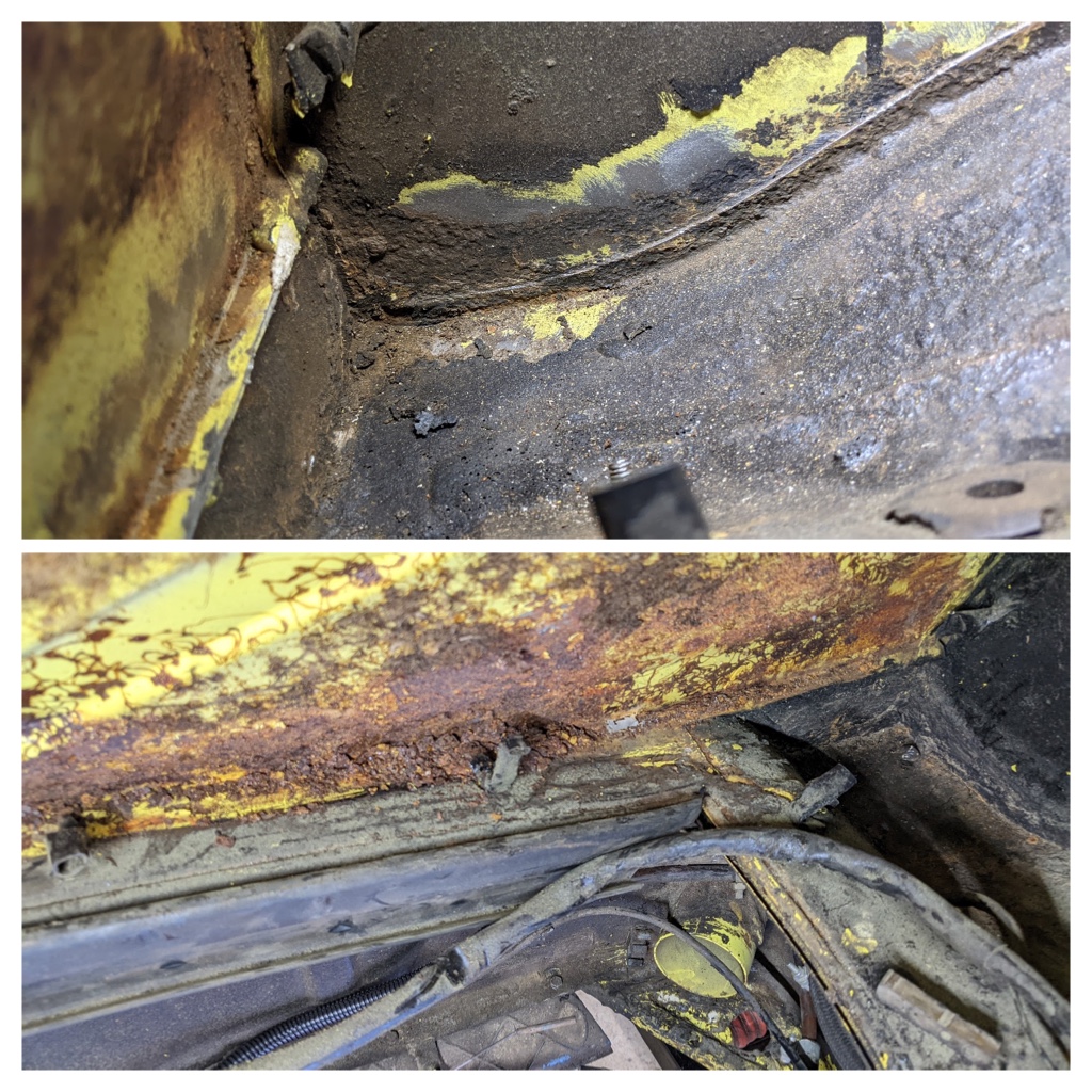

So the theme of today is: Better lucky than good any day of the week!
I saw some rust chips under the firewall pad when I pulled the engine so I knew that needed an investigation. But while assessing that, I also saw some inclusions in the coating in the hell hole. Unbelievably, all of the metal is still solid!
I have a lot of grinding still to do before I can phosphate and seal… but man did I get lucky. (IMG:style_emoticons/default/shades.gif)
