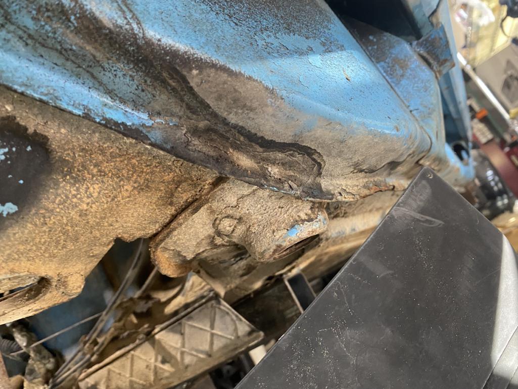

Starting with the frame area around the battery tray drip zone. It looks pretty good imho.
Below the battery tray:

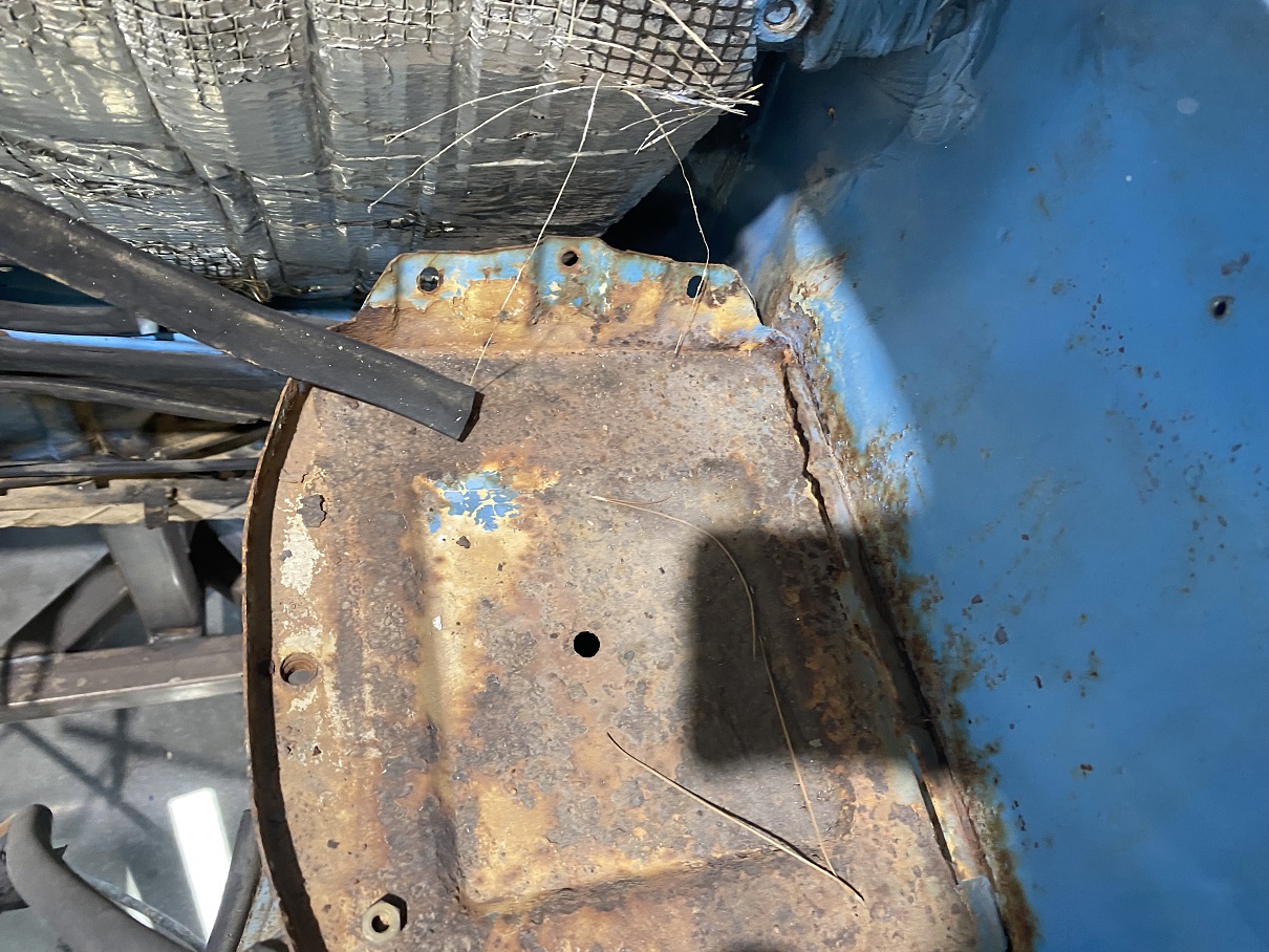

The battery tray:

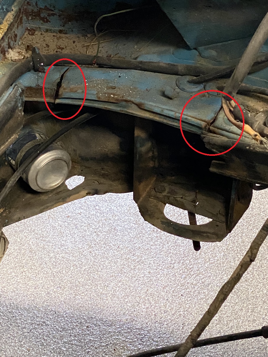

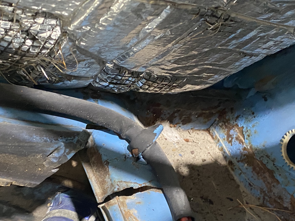

A weird cut section in the engine area. I need to ask PO about this. May have been prep to install the 3.6 for clearance. I hope it's not structural. Also if anyone has a good guide to a 2.7 six conversion keeping the 901 and 4 lug, I'd appreciate it.

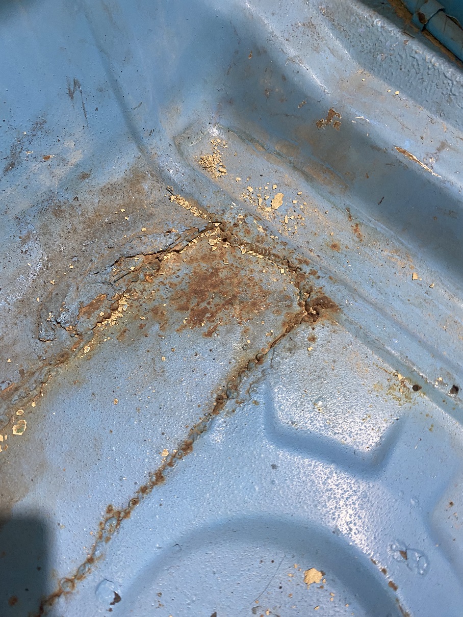

Poor patch panels in frunk:

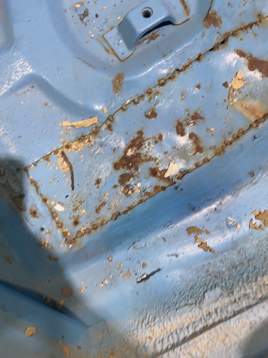

2nd patch area that's only spot welded?

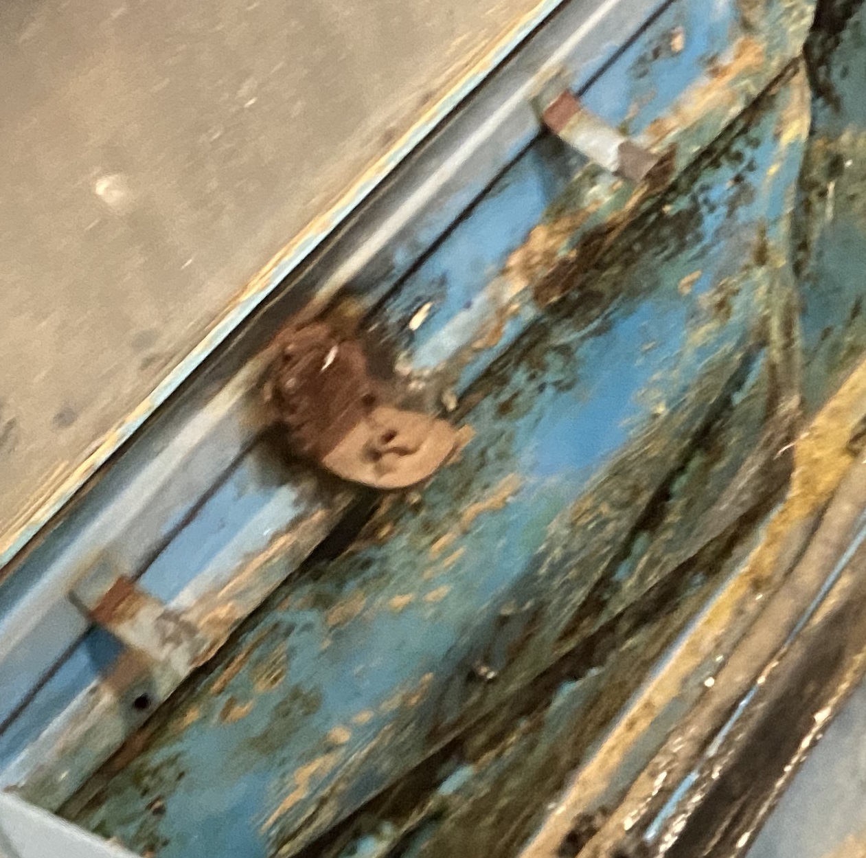

Both engine lid brackets have been booger welded up. I guess this might be a common break point?
Even though this is a fun driver, I'll probably patch in a trunk floor and look for some brackets, and see about fixing the battery tray and hole below in terms of wire wheeling it off, and maybe getting some 2k in a can to hit that area.

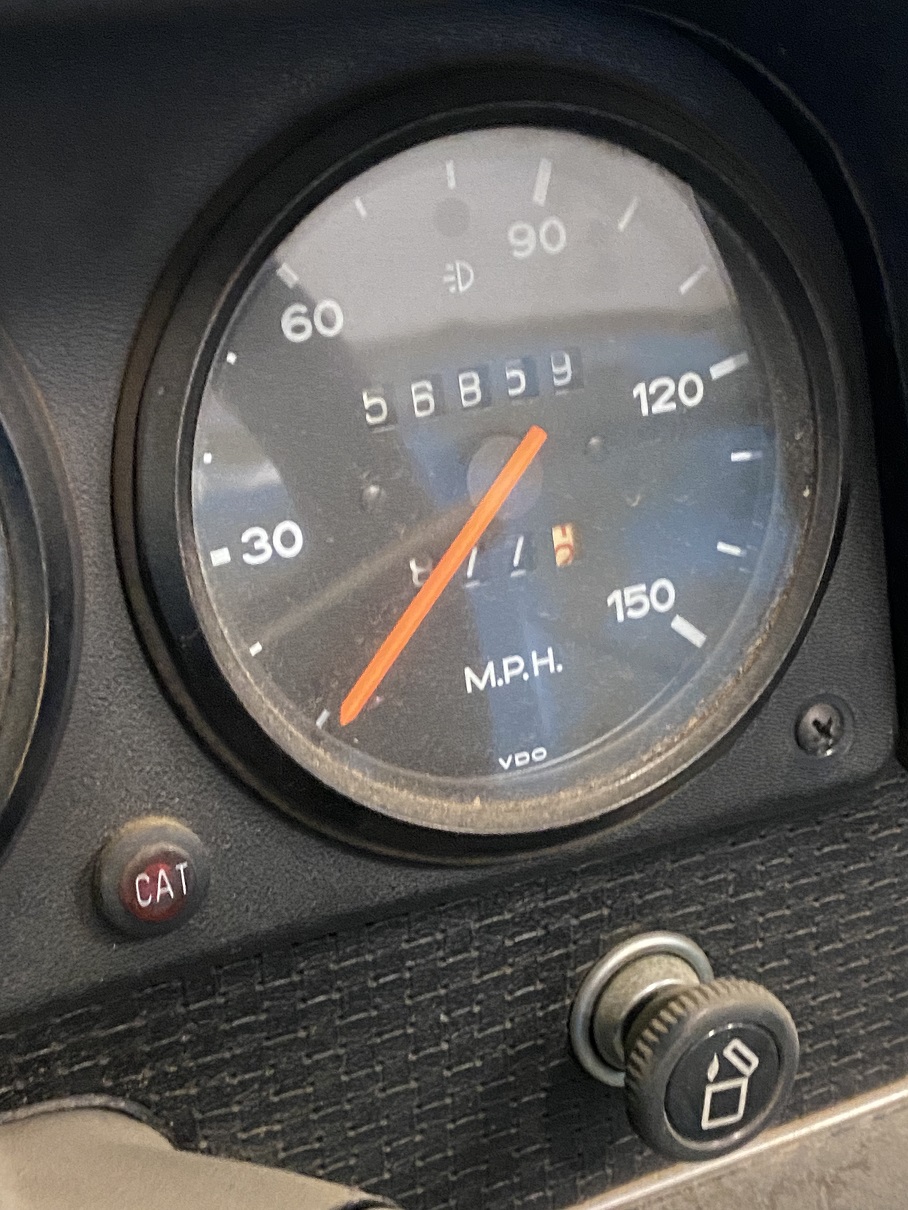

I'm guessing 156k miles if the speedo gear isn't broken.

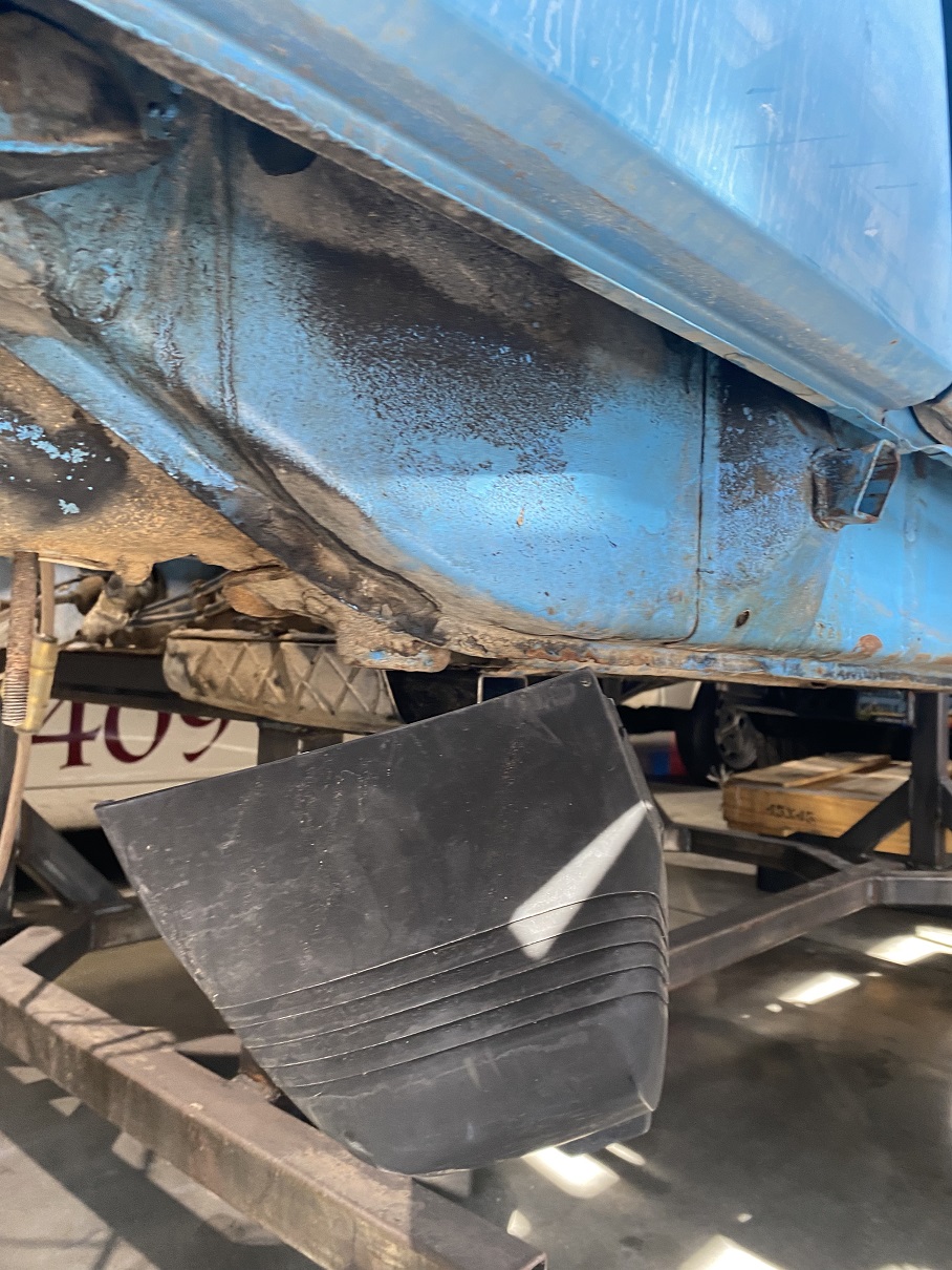

Graydingo   Last week I stopped off at Bill Rader Motorsports ...   Sep 17 2026, 07:17 AM
Graydingo   A little progress on the 914/6 GT tribute. PMB s...   Oct 1 2026, 07:34 PM
Graydingo   More progress on the 914/6 GT tribute project thin...   Oct 18 2026, 10:01 AM
