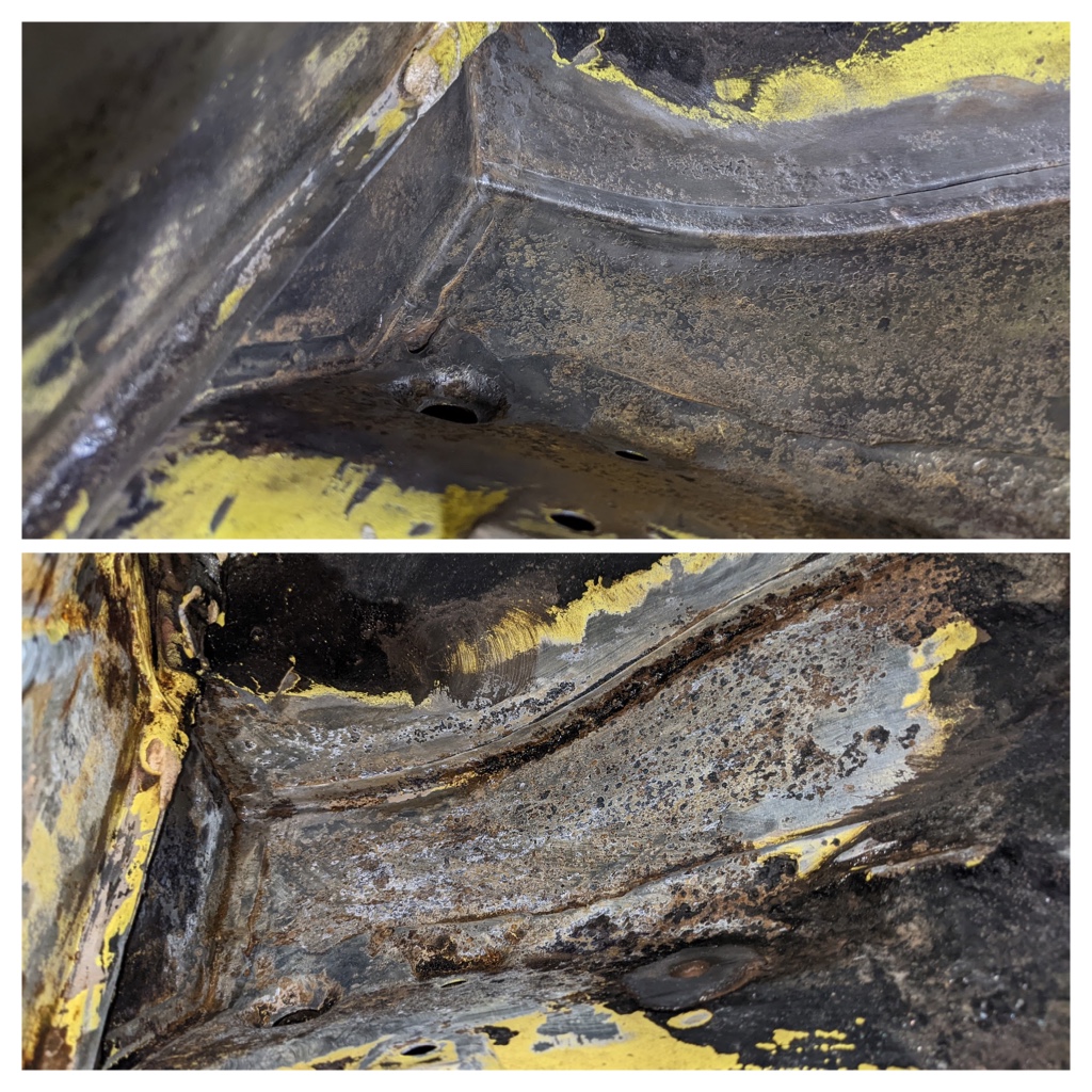

Electrolysis for the win. Only had a couple hours to work today, but I made the most of it. So glad I took out the home made kit, otherwise I wouldn’t have been able to expose that inclusion.

Van B   Electrolysis for the win. Only had a couple hours...   Aug 21 2022, 06:37 PM
wonkipop   still a lucky man. have you taken the sill roc...   Aug 21 2022, 11:51 PM
Van B   Haven’t taken the rockers off yet, but I’m rea...   Aug 22 2022, 03:13 PM
