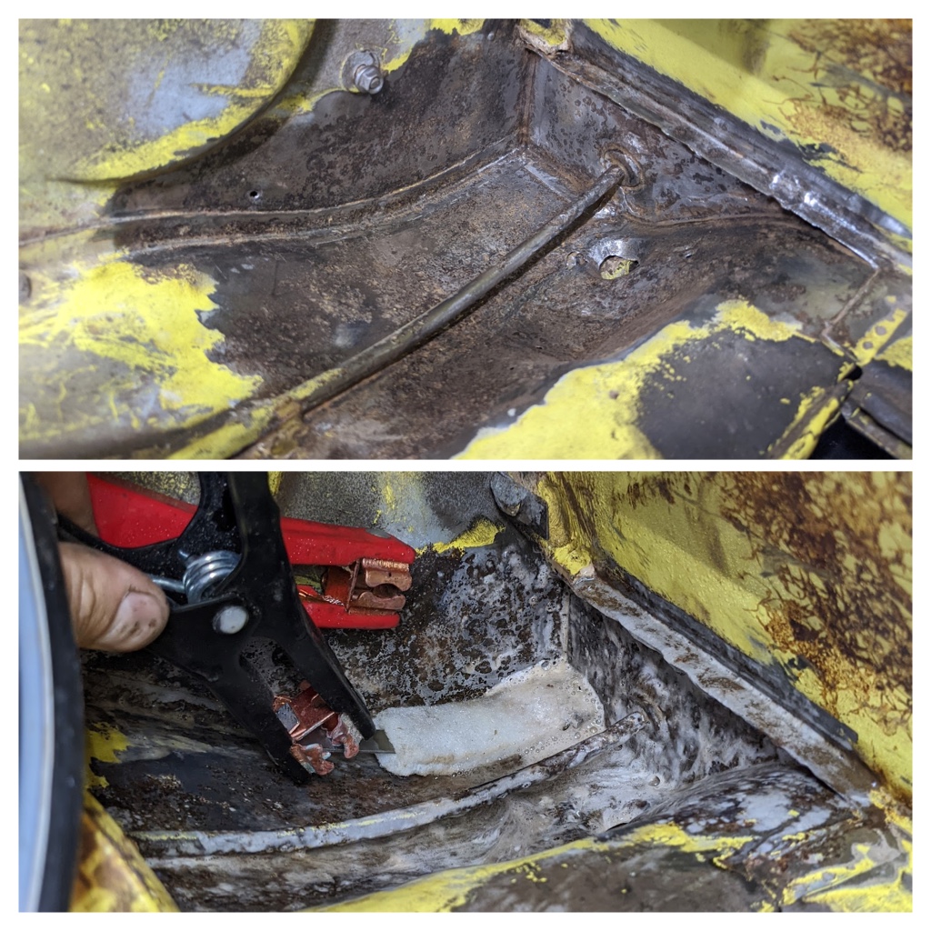

Haven’t taken the rockers off yet, but I’m reasonably confident they are fine.
However, I did take the day off and I guess if yesterday was the hell hole, then today was spent in purgatory… turns out, purgatory is worse lol!
I made sure to take a pic of the electrolysis magic today. Gotta love science!

Van B   Electrolysis for the win. Only had a couple hours...   Aug 21 2022, 06:37 PM
wonkipop   still a lucky man. have you taken the sill roc...   Aug 21 2022, 11:51 PM
Van B   Haven’t taken the rockers off yet, but I’m rea...   Aug 22 2022, 03:13 PM
