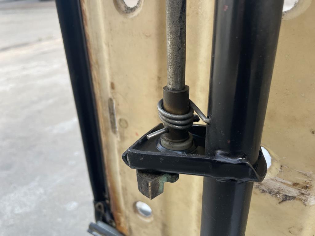

My seat rails are pretty fugly. They are solid and operate flawlessly. Bushings in good shape with no cracking observable. The paint, however, is the opposite of good. I'd like to get these cleaned up repainted or powder coated.
My concern and caution is that if I take the spring's retaining pin out then I won't be able to get it reassembled. Can anyone share a method to R&R that retaining pin and spring, hopefully not needed a shop press? ![]() ![]() Thank you, Sean |

I took mine off thinking I will find a way to put this back on. I tried and tried, but after t popped off like 10x I gave up and I have the end of a punch that I managed to pry the spring into position and get it through the hole then cut off.
I think I saw someone did it with a pair of needle nosed pliers? I'd also like to know if there's some trick to this. |

Mikey914 We make a rebuild kit with tool to install
https:/... Aug 22 2022, 08:22 PM
bdstone914 @seanpaulmc
Get a metric roll pin punch to remove... Aug 22 2022, 08:39 PM

iankarr +! for 914rubber's rebuild kit. I used it ... Aug 22 2022, 10:01 PM
Olympic 914 If you look at my build thread, post #29.
I used a... Aug 23 2022, 06:59 AM

nathanxnathan I’m going to have to give the seat roll pin anot... Aug 23 2022, 08:58 AM
Mikey914 I have 6 on the shelf. These should be shown back ... Aug 23 2022, 06:39 PM
seanpaulmc Love the turnbuckle idea so I bought this today an... Aug 24 2022, 05:52 PM
