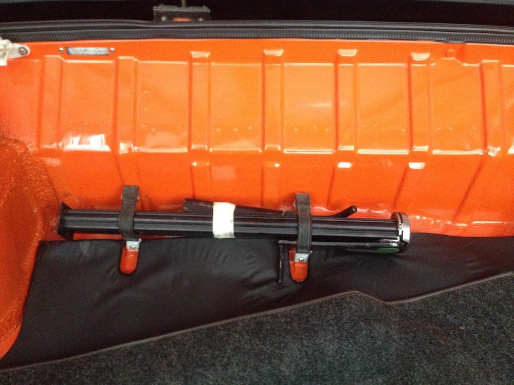

does it look like this (mine - soft pad) , or is it the more rigid type that most earlier cars have.
apologies @Van B . not intending to side track. (excuse = bringing it back/originality).

Van B   Wonki, this is mine. Glued down and doesn’t com...   Aug 25 2022, 05:06 PM

wonkipop   thanks @Van B (ah the interlock, the horror, th...   Aug 25 2022, 05:27 PM

Van B   Getting a little behind on updates here. I know t...   Oct 12 2022, 11:15 PM
Van B   After the firewall, a lightbulb came on that resul...   Oct 12 2022, 11:18 PM
