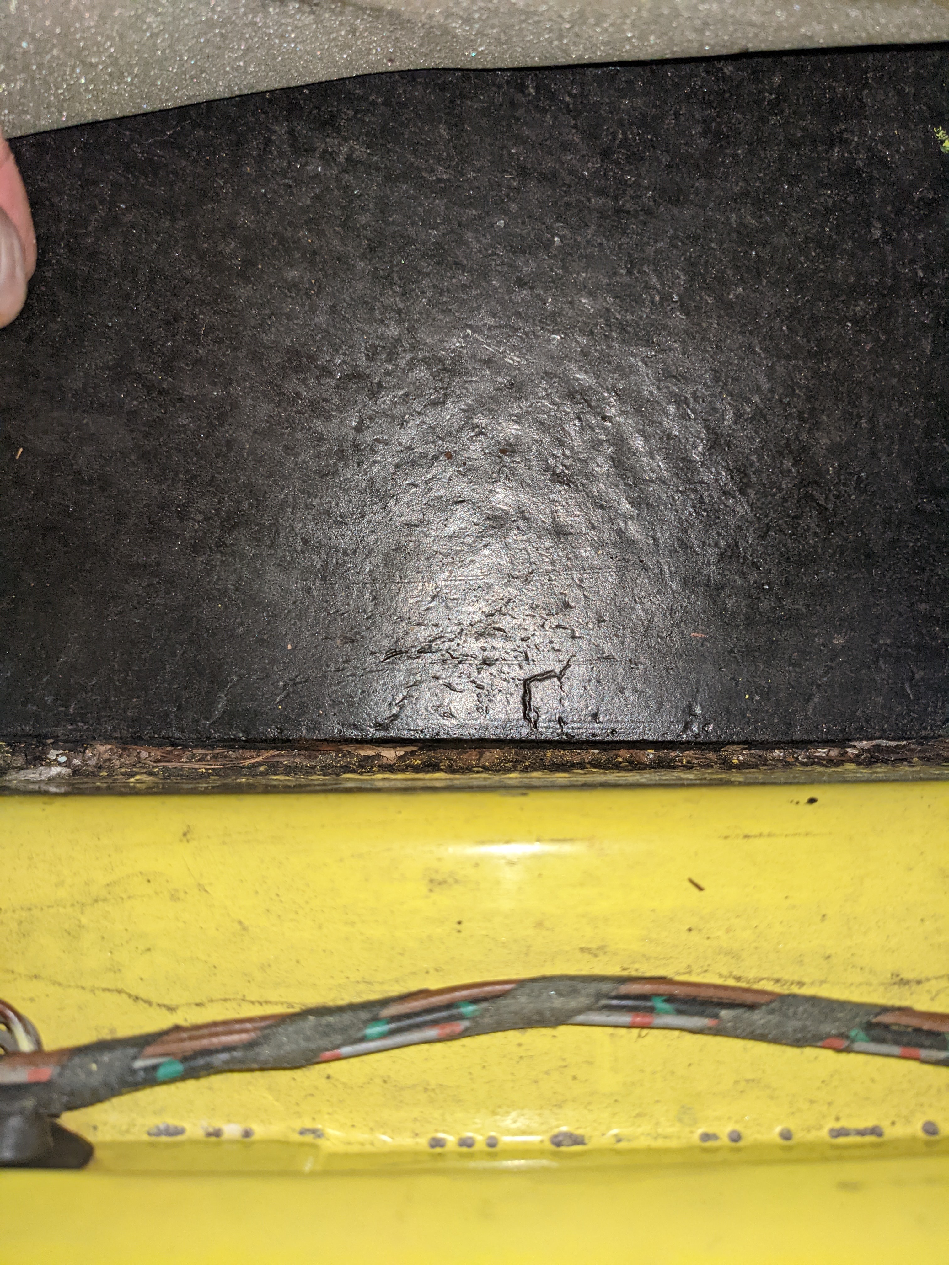

Wonki, this is mine. Glued down and doesn’t come up… I tried but it feels very old lol.
