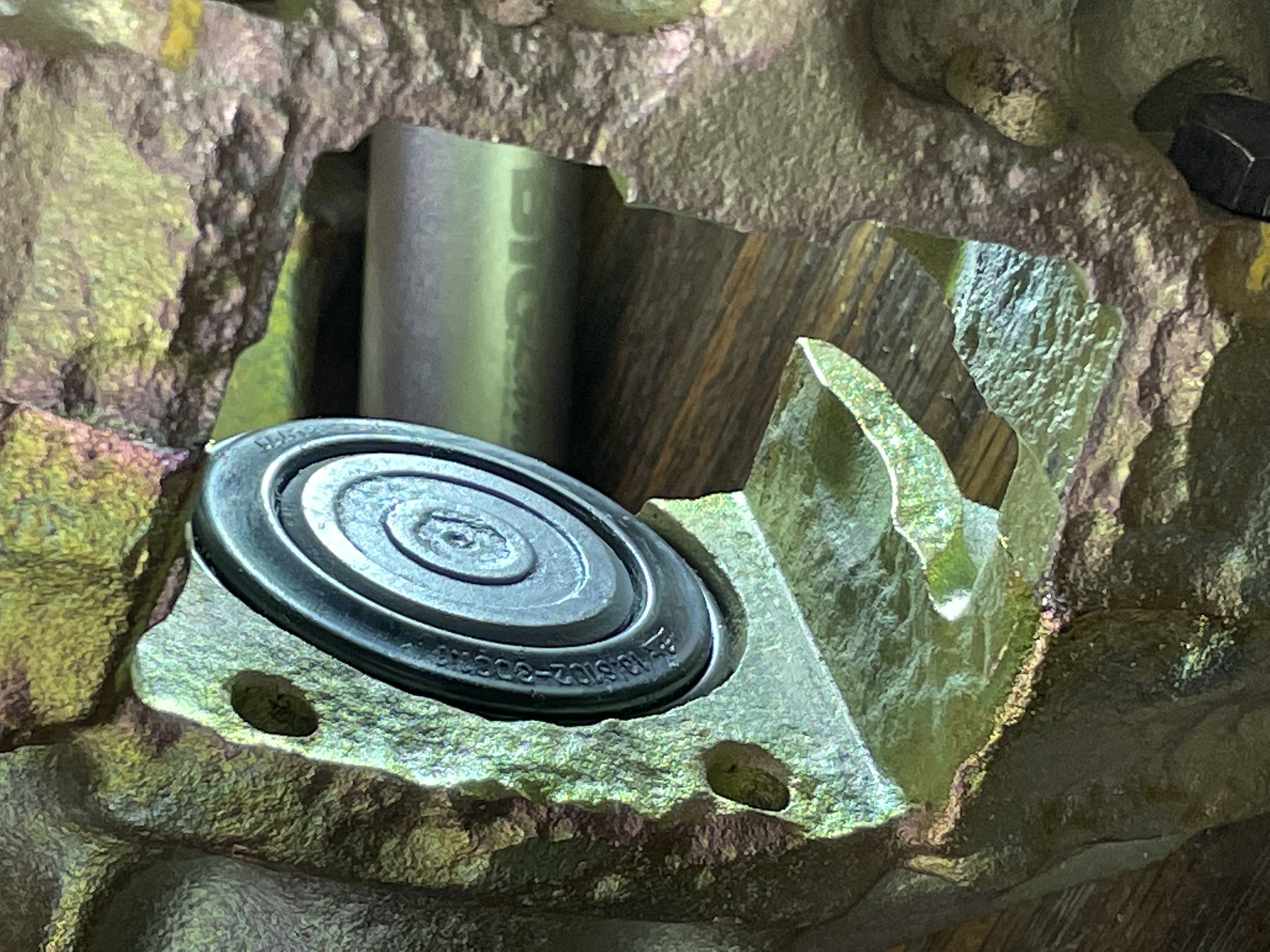

Very disappointed when I received 2 rebuilt calipers and one obviously had some considerable corrosion before being restored. After cad plating it looks like a gold nugget. The pad resting areas are extremely pitted and uneven. Pads move a lot more in the caliper than in my original calipers. Will this lead to any issues if I decide to use them?

930cabman   From what I can tell the area in question is a sli...   Aug 16 2022, 05:45 AM
914Sixer   I would be worried about metal fatigue on the pin ...   Aug 16 2022, 06:01 AM
BillJ   I never ever mess with less than perfect with the ...   Aug 16 2022, 06:07 AM
PatMc   That’s trash.   Aug 16 2022, 07:18 AM
mepstein   There might not be a functional issue but I would ...   Aug 16 2022, 07:23 AM

Root_Werks   Wouldn't use it either, there are still good c...   Aug 16 2022, 10:03 AM
krazykonrad   Just as the tree is coming through your windshield...   Aug 16 2022, 10:50 AM
Brian Fuerbach   I will try to exchange it or just return the compl...   Aug 16 2022, 11:08 AM

Puebloswatcop   Absolutely not. I can't believe any reputable...   Aug 16 2022, 12:03 PM
Mikey914   I understand cores are getting hatder to find. Whi...   Aug 16 2022, 01:32 PM
burton73   Question is, how did that make it all the way to y...   Aug 16 2022, 04:29 PM
Brian Fuerbach   Question is, how did that make it all the way to ...   Aug 16 2022, 04:55 PM

930cabman   I would give the rebuilder the benefit of a doubt,...   Aug 16 2022, 06:19 PM
PatMc   The degradation we see here can probably be rep...   Aug 16 2022, 06:42 PM

bkrantz   Junk. And if a sketchy rebuilder sells calipers t...   Aug 16 2022, 08:01 PM
Van B   I’m mind blown by what I’m looking at… PMB h...   Aug 16 2022, 08:30 PM
Geezer914   pull the pistons if they are good and use the cali...   Aug 17 2022, 05:18 AM
