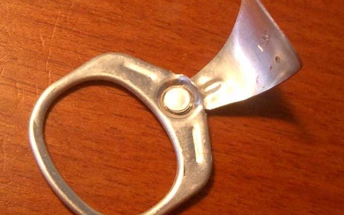

We always called that washer a "Beer Tab", because it looked similar to the old beer tabs from the 70s, and because we are old and can actually remember the 70s.
(IMG:http://www.914world.com/bbs2/uploads_offsite/westerndigs.org-1143-1661522043.1.jpg)
