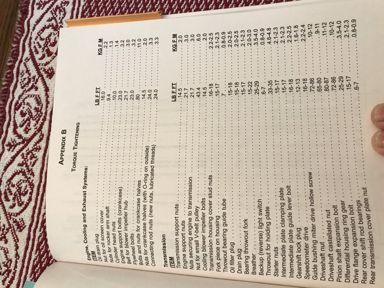

Van; does this help? From George’s Tech Tips 700, page 103.

StarBear   Van; would these be the torques you mentioned? #2 ...   Aug 19 2022, 03:13 PM
Van B   Steve, for the life of me, I can’t find the M12 ...   Aug 19 2022, 05:09 PM
StarBear   :cheer: :Qarl: :beer2: Onward! Thanks and b...   Aug 19 2022, 05:35 PM

StarBear   Van; does this help? From George’s Tech Tips 700...   Aug 27 2022, 12:36 PM
Van B   It ain’t listed there either @StarBear , but if...   Aug 27 2022, 06:28 PM
StarBear   It ain’t listed there either [b]@[url=http://w...   Aug 27 2022, 08:00 PM
Van B   Almost everything new you can buy will be 8.8 at l...   Aug 28 2022, 07:54 AM
