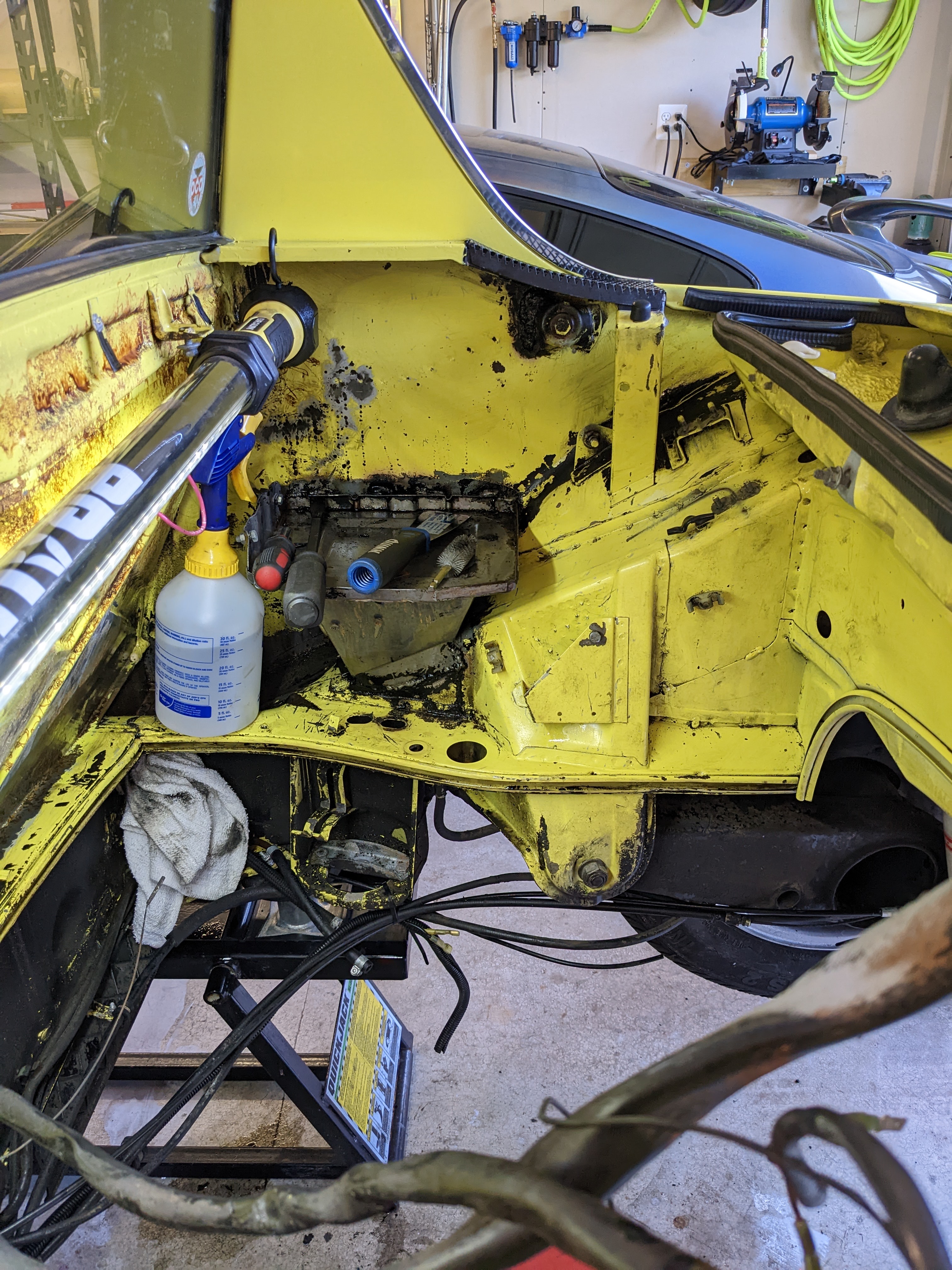

Been spending a lot of time LARPing as a type 4 engine these past weekends lol…. But, I want to uncover any and all issues as well as set myself up for a quality finish with my high dollar 3M undercoating. Today I spent the afternoon soaking the 50yr old Ziebart in mineral spirits and using all manner of tools and rags to remove it.
Pretty pleased with how much I removed today and the condition of the metal and paint underneath. I learned that the battery tray was replaced some time ago… and not properly primed or painted lol.

QUOTE(Van B @ Sep 2 2022, 06:12 PM) *
Undercoating hides all kinds of sins, especially on 914s. (IMG:style_emoticons/default/happy11.gif)
