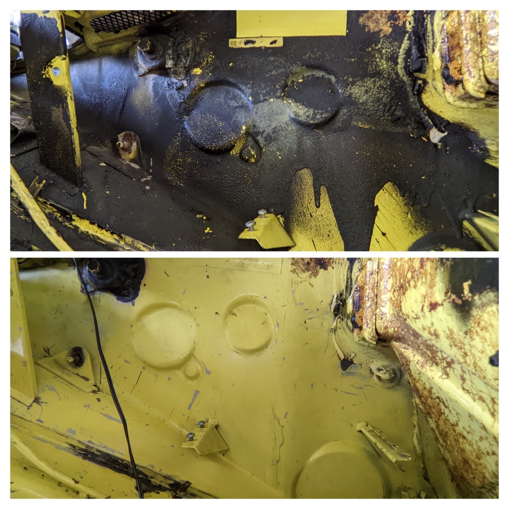

Man… such an absolutely tedious task. But I know I will be glad I did it in the years to come. The problem with Ziebart and other traditional undercoatings is that when it’s not sprayed properly, it foams… And that traps moisture.
The new stuff, like 3M Dyna-Pro 544, is vastly more expensive, but it doesn’t trap air bubbles and is paintable. After seeing all this yellow for the first time in 50yrs, I’m considering the idea of painting the bay yellow. But also, my original plan was for a smooth satin black finish that would let the refinished engine be the star.
It’s important to me the car should keep its stories. It is a survivor after all.

Van B   I did some sand blasting in the engine bay yesterd...   Sep 24 2022, 07:41 PM
Van B   Did some fine grit soda blasting on the longs… d...   Sep 25 2022, 10:53 PM
Van B   As for the engine bay, I’ve finally reached the ...   Sep 25 2022, 11:03 PM
