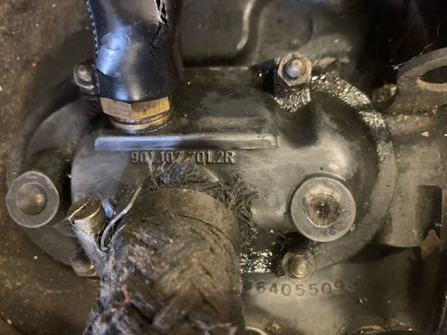

Is this a correct Oil Cover Lid for a 1970 914-6? It appears to have a threaded port for a temperature or pressure sensor / switch. I can't find that part number in the 914 or early 911 parts catalogs.
901.107.701.3R

My -6 engine which happens to be on the floor at the moment. Built 450 odd away from yours
.2R same as Rory's initial pic
