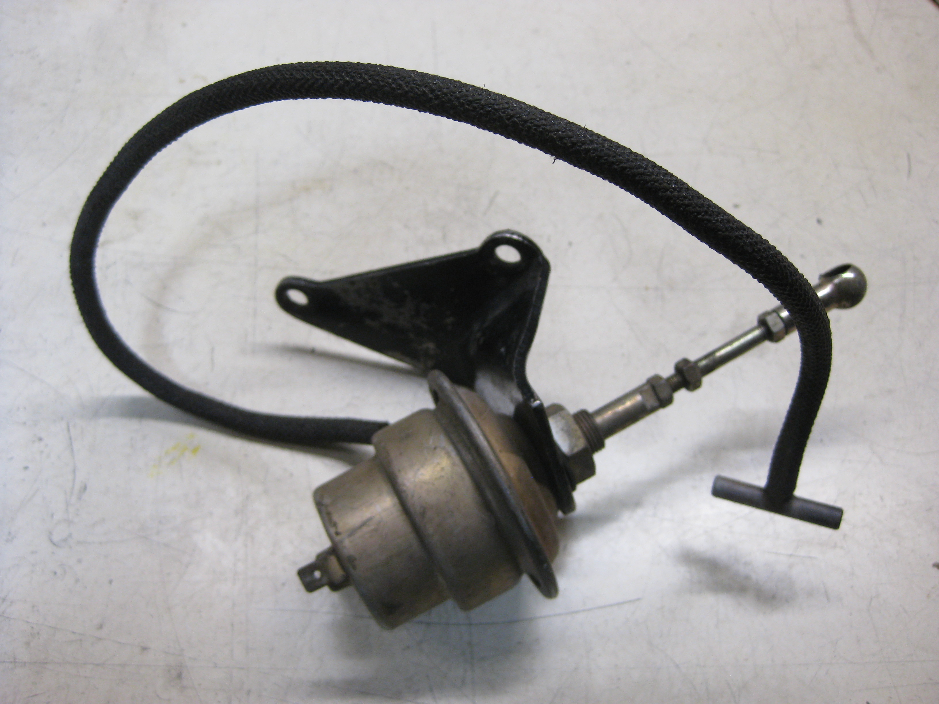

914-6 Throttle Valve Positioner....the vacuum "pot"

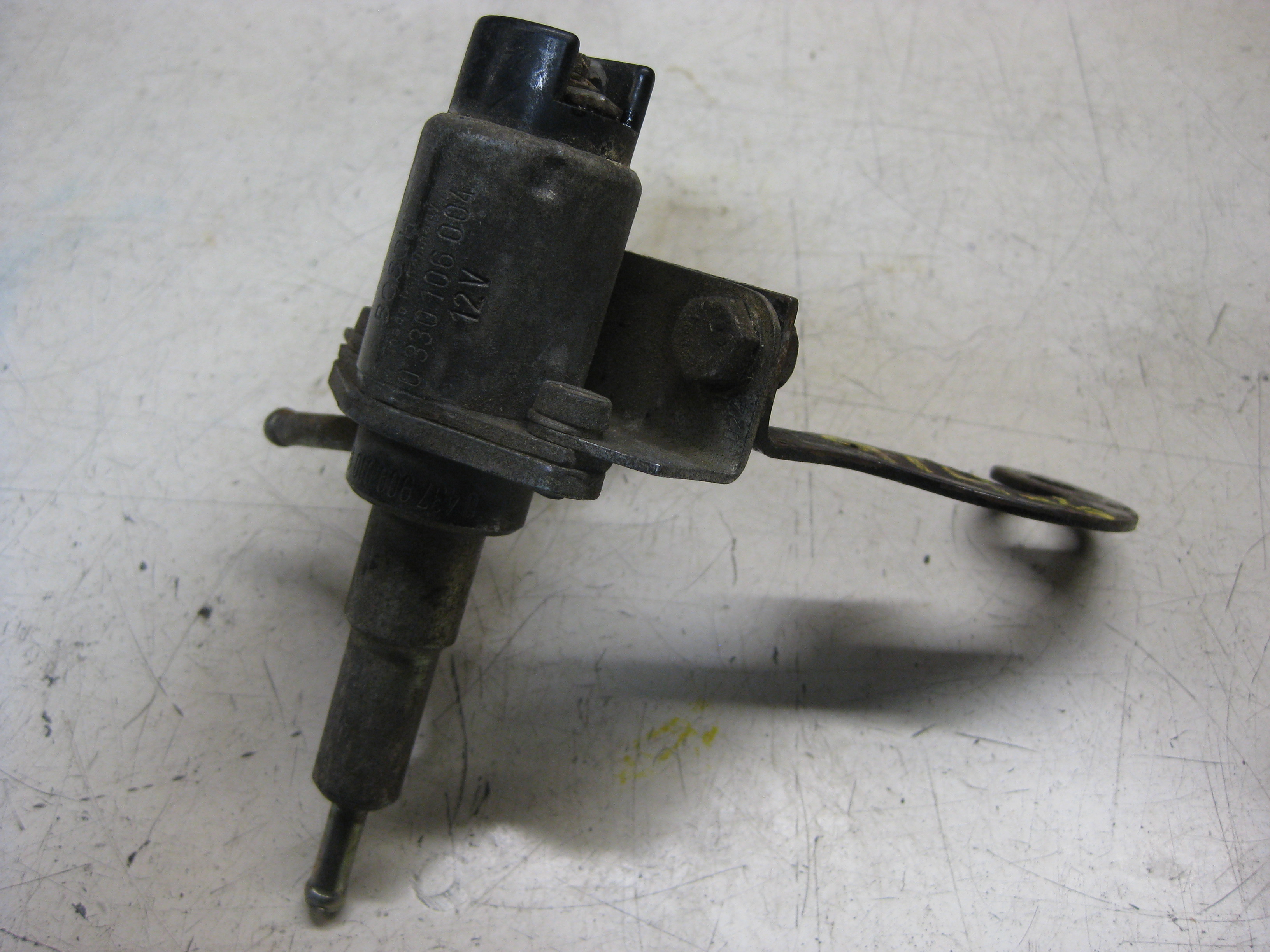

914-6 Cold Start Valve
The fire starter that dumps raw fuel into the air box
DennisV   Oil Breather Cover Lid   Sep 4 2022, 06:23 PM
rgalla9146   Is this a correct Oil Cover Lid for a 1970 914-6?...   Sep 5 2022, 05:59 AM
nditiz1   I thought all 6s were carbd which would mean no TP...   Sep 5 2022, 06:36 AM
SixerJ   My -6 engine which happens to be on the floor at t...   Sep 5 2022, 07:50 AM
johnhora   The "TPS" was used as an early emissions...   Sep 5 2022, 08:10 AM
rgalla9146   Original equipment on our cars was a temp sensor ...   Sep 5 2022, 08:18 AM
johnhora   914-6 Throttle Valve Positioner....the vacuum ...   Sep 5 2022, 08:33 AM

fixer34   Had me curious so I went to look. March '70. ...   Sep 9 2022, 12:20 PM
fixer34   I have wondered for a while what the sensor was th...   Sep 9 2022, 12:27 PM
rgalla9146   I think that switch (two wire) was the trigger for...   Sep 9 2022, 01:30 PM
