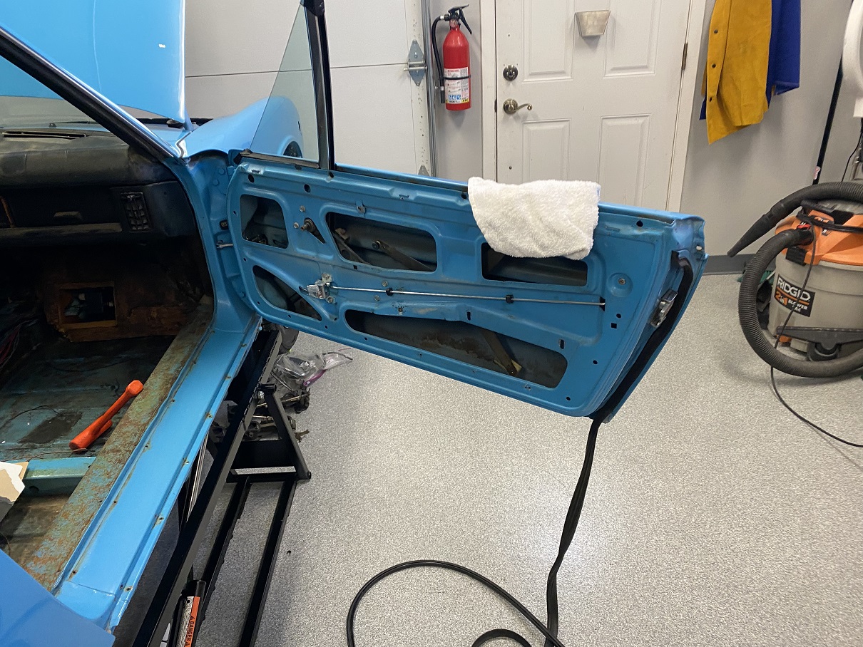

Well a lot has transpired in the last few weeks. Mainly parts acquisition and some door work.

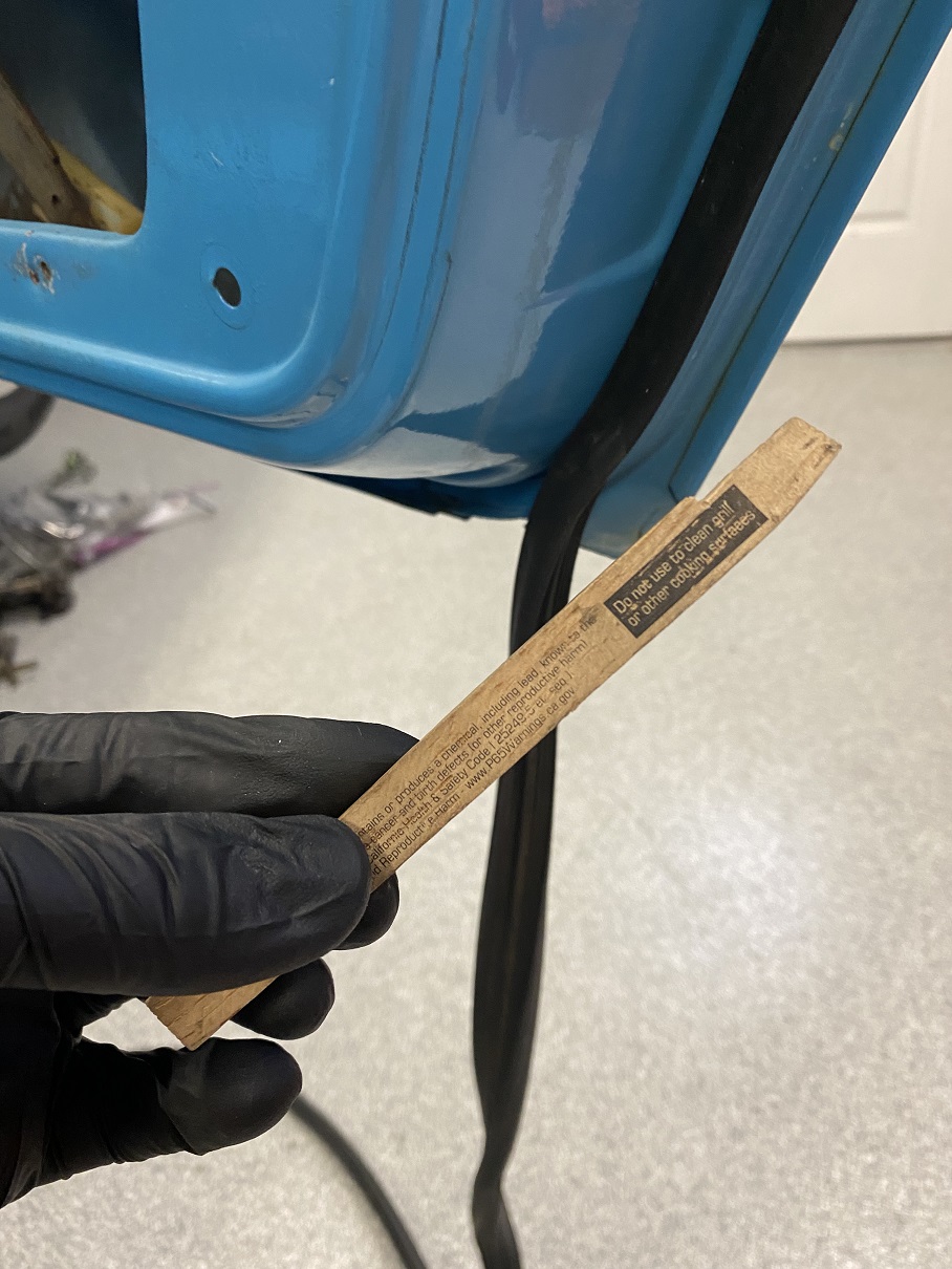

I bought the door rubber kits from 914Rubber as well as the full trunk kits. I figured I wanted everything that opens and closes to work and seal properly.
I made this little wood tool by cutting off the end of a brass wire welding brush:
The doors were all goofed up, but I've got them opening and closing much better now.

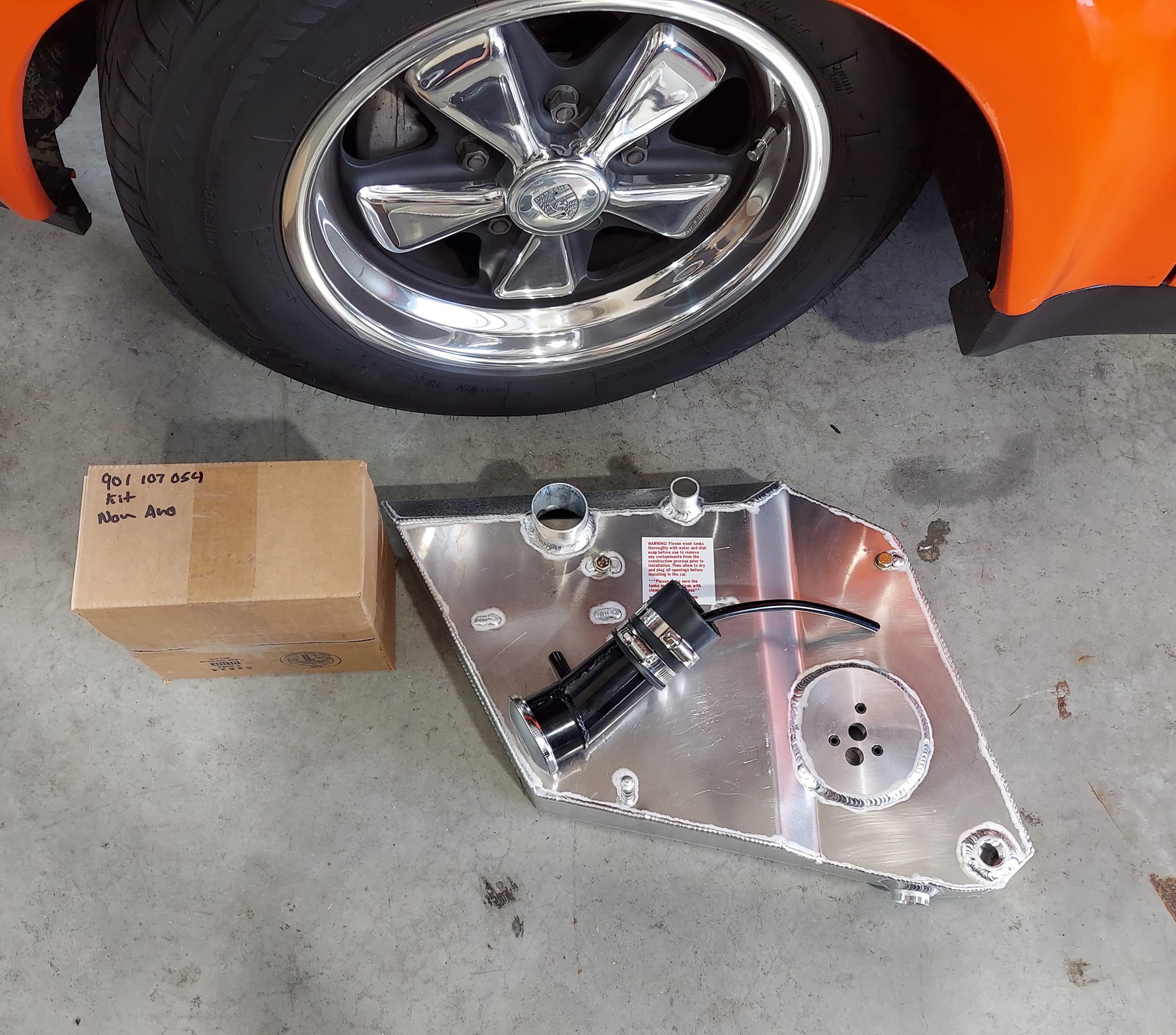

Moving on, over the Labor day weekend, I saw that Maddogsmotorsports was having a labor day sale, so I bought the engine mount system he has:
Now I'm wondering if I need the swing arm reinforcement kit and the frame reinforcements like the 6 apparently had.
I also purchased a 6 tank kit from Ben Mcfarland:

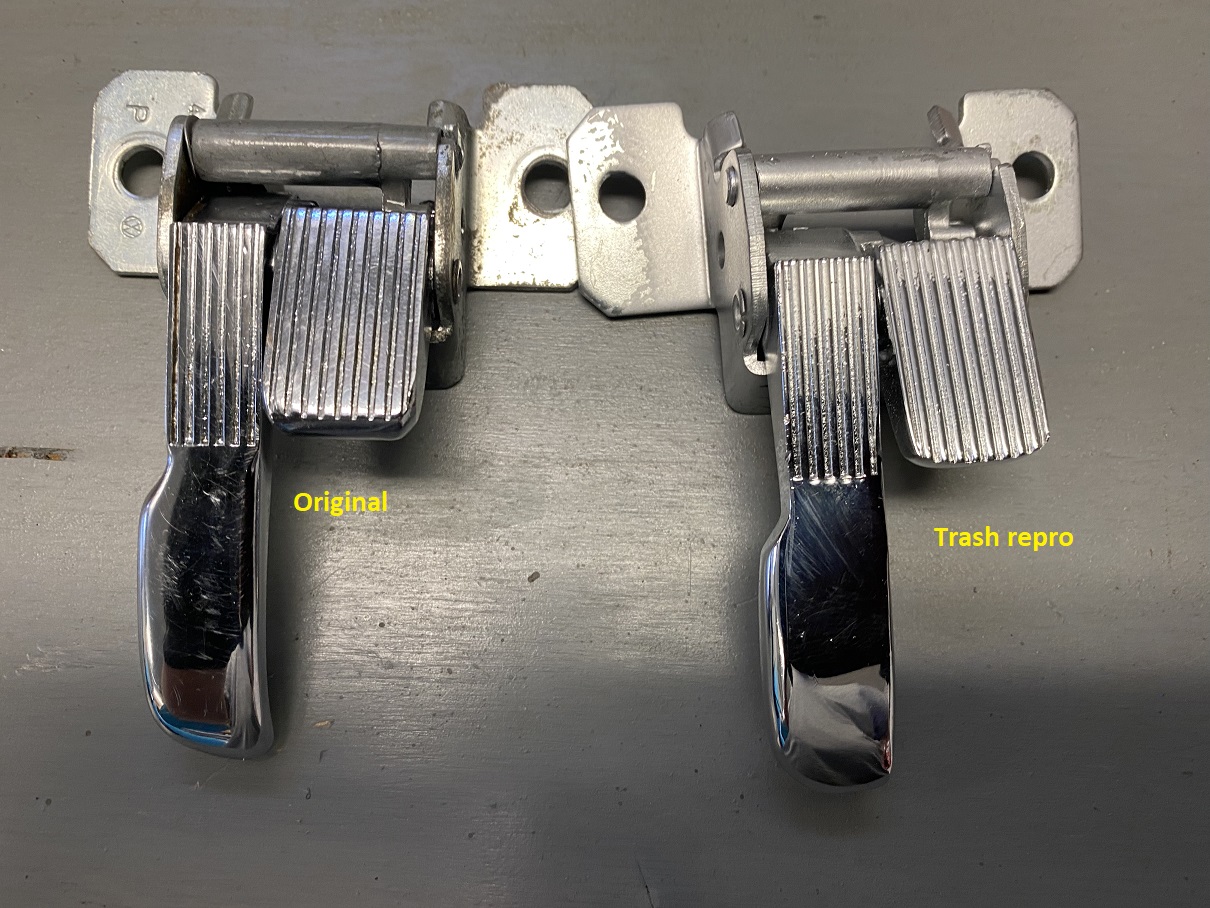

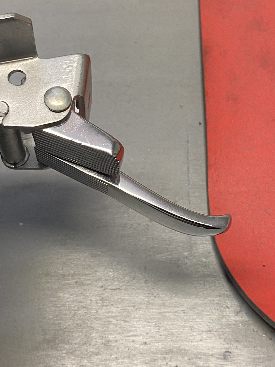

I had also bought reproduction interior door handles and the drivers latch was an epic piece of trash.
The housing was squeezed tight making the latch bind up. I tried fixing it but the overall quality is really poor from the entire construction to the terrible paint the covered it in.
While at Carl's place I asked the owner Tony if he had any door parts. Tony found a drivers door with a good latch and pulled it out for me. Tony also had a pile of original back bumpers. So I found the straightest one for the bumper backdate. If anyone has a core front bumper let me know. I'll probably ship it to Ben to do the cooler opening mod.
