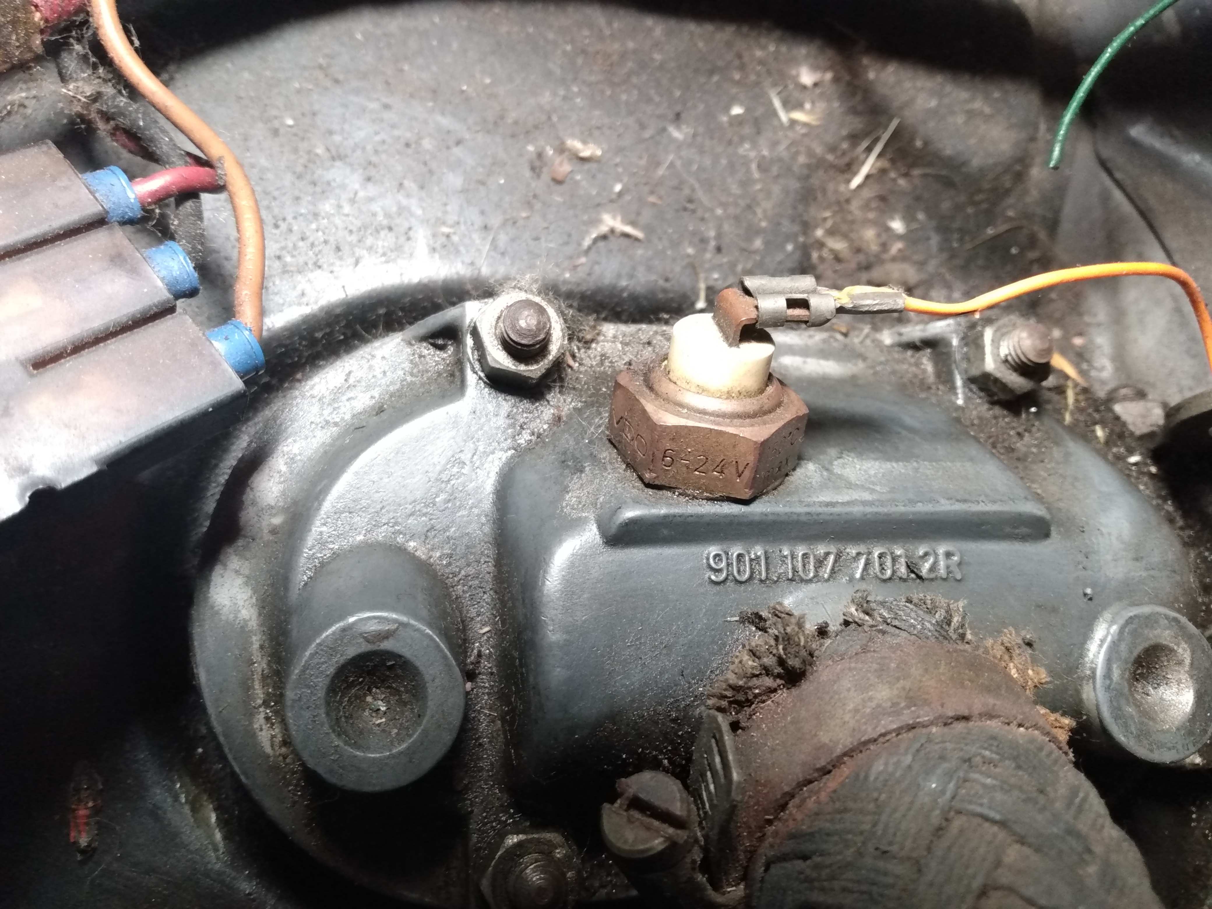

Is this a correct Oil Cover Lid for a 1970 914-6? It appears to have a threaded port for a temperature or pressure sensor / switch. I can't find that part number in the 914 or early 911 parts catalogs.

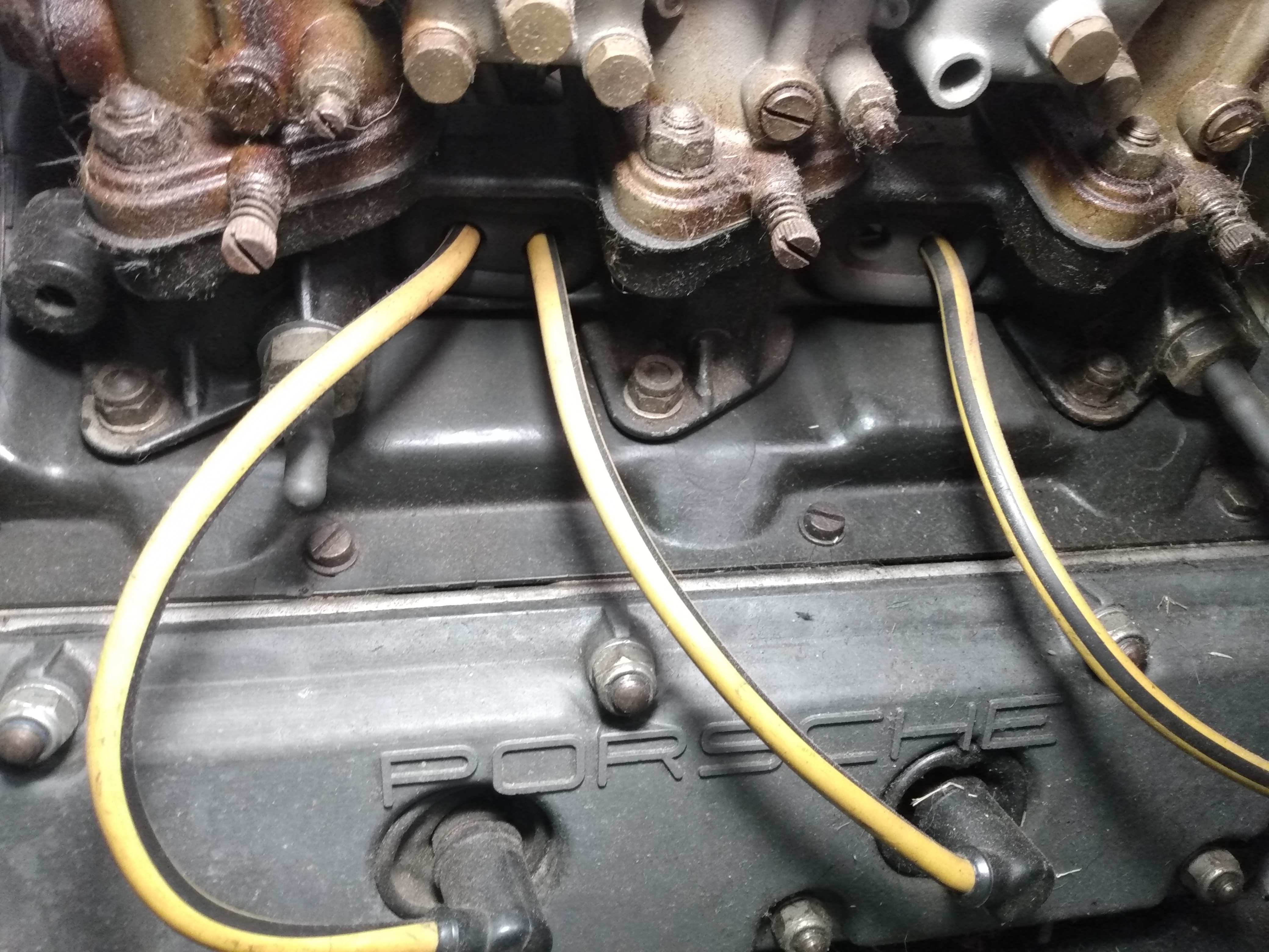

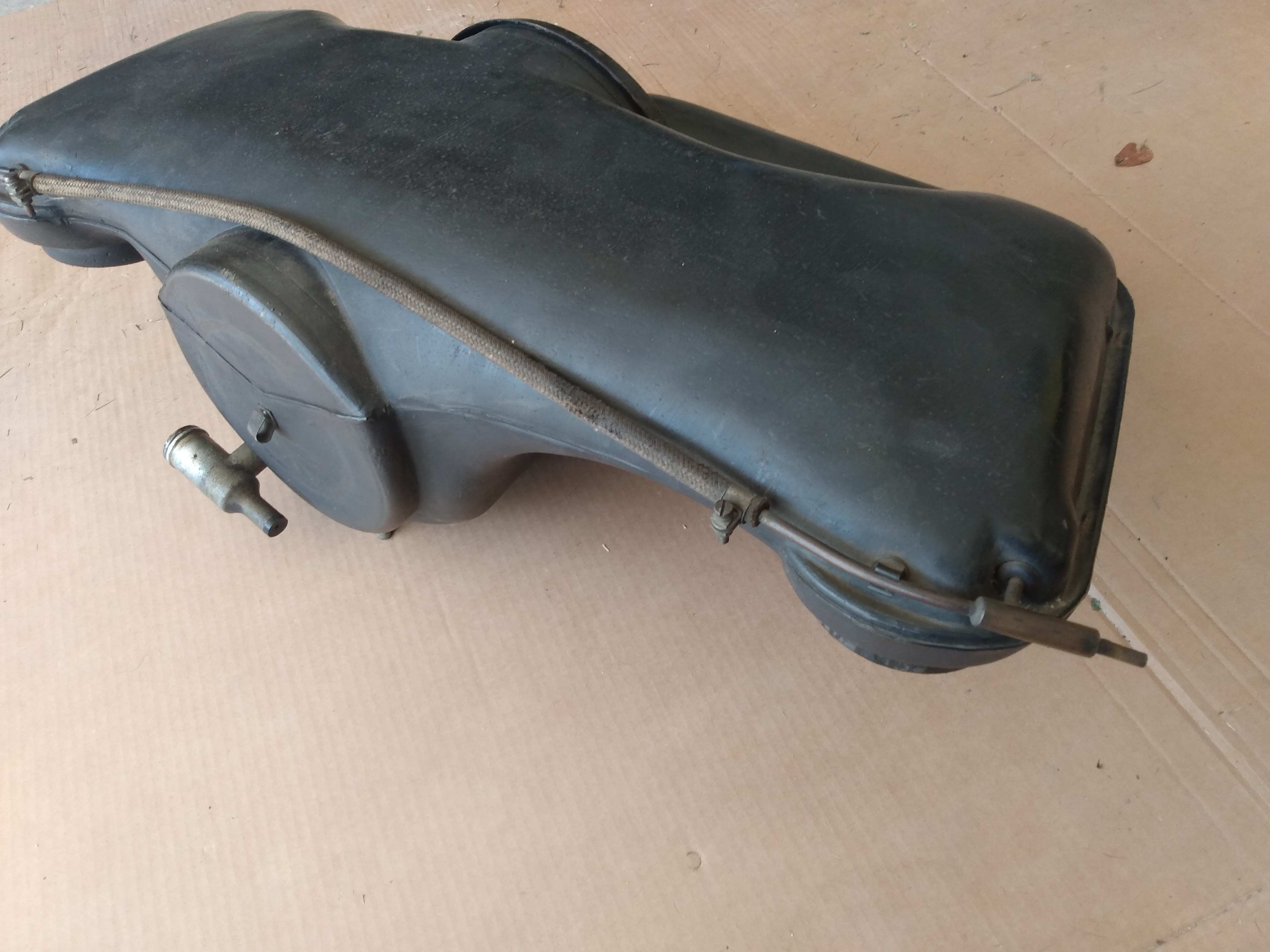

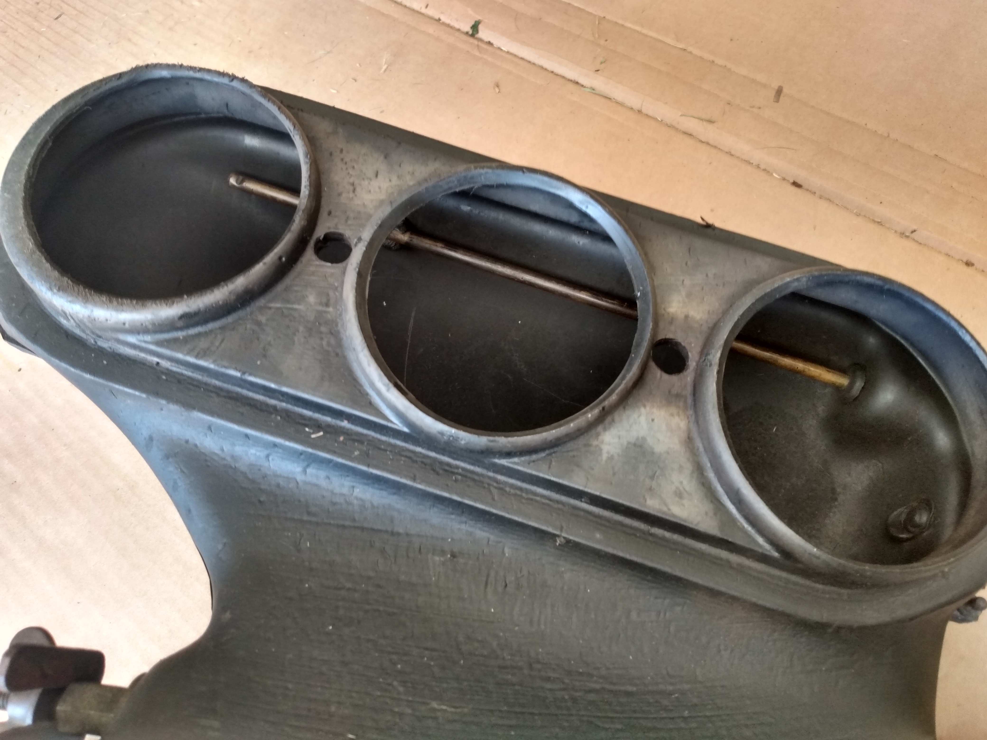

Had me curious so I went to look. March '70. Oil breather is the 2R with the sensor hole toward the front. I put an aftermarket temp sensor in there when I pulled the cold start pieces long ago. Left the pipes in the air housing. A couple rubber caps on the manifold took care of the removed vacuum hoses.
