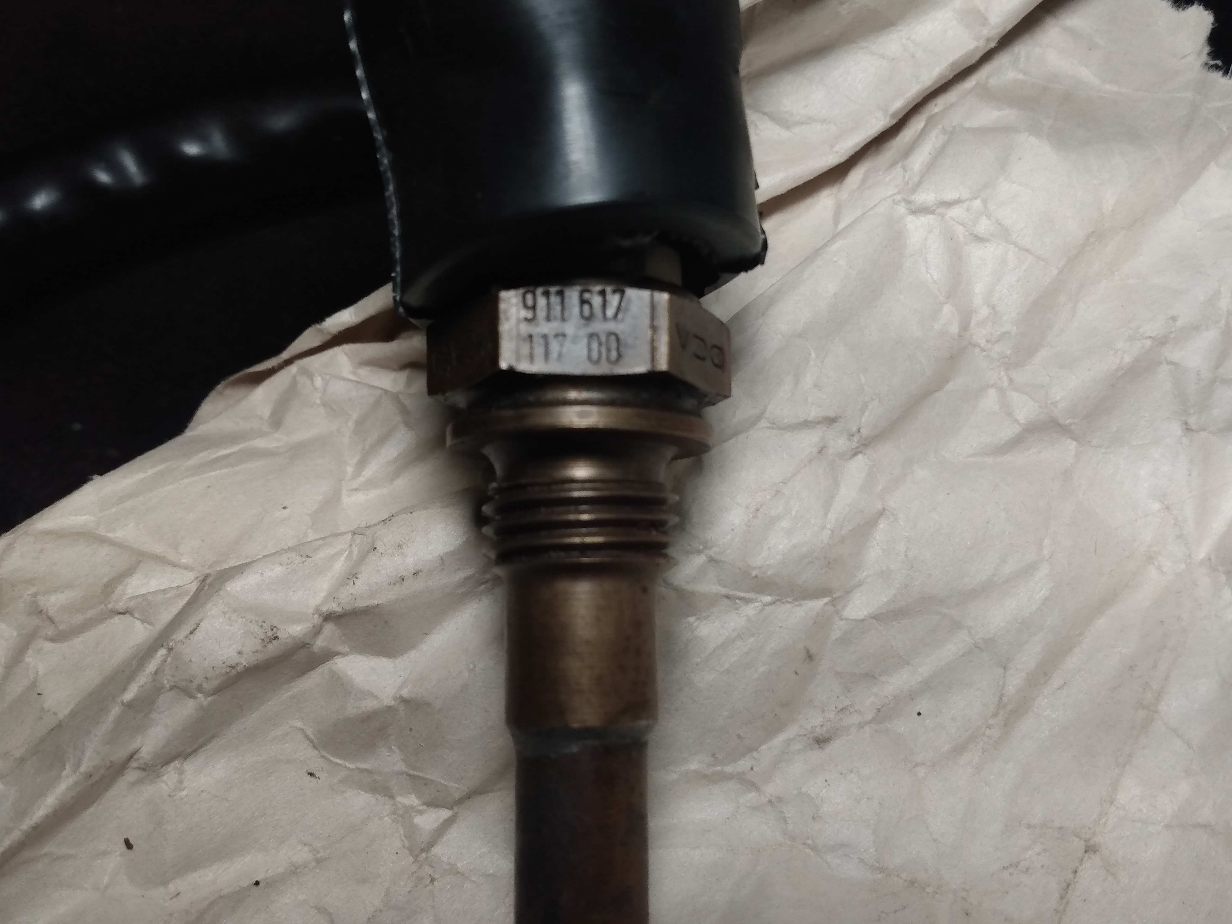

Is this a correct Oil Cover Lid for a 1970 914-6? It appears to have a threaded port for a temperature or pressure sensor / switch. I can't find that part number in the 914 or early 911 parts catalogs.
901.107.701.3R

I have wondered for a while what the sensor was that was 'floating' around by the breather. I obviously took it out a long time ago, but I don't remember why. It has been connected all this time, but has 2 contacts on the top under the rubber cover unlike the first picture. I got the p/n if anyone can reference it.

fixer34   Had me curious so I went to look. March '70. ...   Sep 9 2022, 12:20 PM
fixer34   I have wondered for a while what the sensor was th...   Sep 9 2022, 12:27 PM
rgalla9146   I think that switch (two wire) was the trigger for...   Sep 9 2022, 01:30 PM
